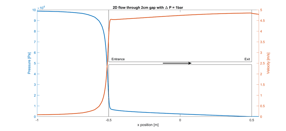

While I find your answer intriguing, it's also over my head. I used this definition for a steady flow: the flow parameters (velocity, density, etc...) at any point cannot change with time. I have no idea what might be buried in the "etc.". Do you have a different definition?
Let's consider this: I use the tube to connect two regions of different static pressure and 0 dynamic pressure. The fluids in these regions are incompressible and of equal fluid density. The regions are so large that I could maintain any flow rate through the tube for years without changing the pressures on either side by any significant amount. So I begin the flow and let it run for hours.
Now I measure the static pressures at five equally spaced regions, stretching from end to end. I'll list pressures relative to the exit (gauge) pressure, with the entrance pressure at 1,000 kPa. I'll assume a frictionless tube, but if you like you can imagine a tube with a small amount of friction. Here are some guesses as to what I might find:
  • 1,000, 750, 500, 250, 0. This gives a nice gradient but violates Bernoulli's equation. More important, there seems to be an unaccounted energy loss. Where is the pressure going? If I assume it is being converted to dynamic pressure, then the continuity equation is violated.
  • 1,000, 1,000, 1,000, 1,000, 0: This satisfies Bernoulli's and the statement that exit pressure is equal to gauge pressure. However, it doesn't explain how we got a flow--it looks like the dynamic pressure is 0 through most of the tube.
  • 1,000, 0, 0, 0, 0: Again, this satisfies Bernoulli's and the exit pressure and it allows for a flow since the static pressure is converted into dynamic pressure. The only problem is that 1,000 kPa of static pressure needs to be converted to dynamic pressure right at the entrance. This seems unlikely to be instantaneous. We could allow for a transition zone, but then we're back to the first option above, just with a shorter tube.

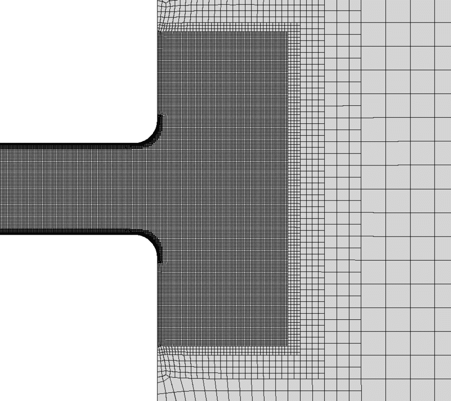

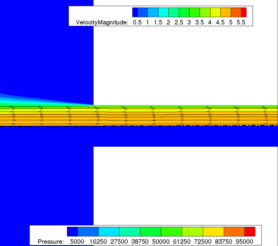

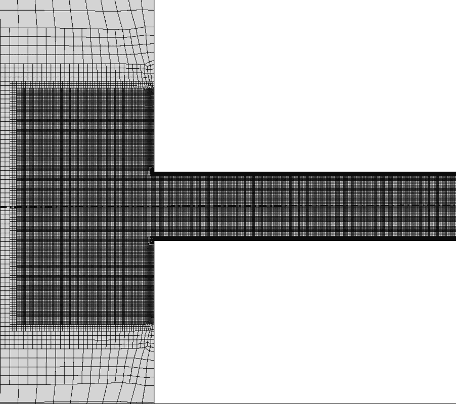

The flow lines in the first tank will be converging towards the input end of the tube, so the fluid flow would have effectively a self-imposed taper. Acceleration would happen in this tapering region just before the point where the tube connects to the reservoir.
Therefore the pressure values in the tube would be something like 100, 99, 98, 97, 95. The drop from 1000 to 100 (occurring in the convergent flow region) accounts for the energy required to accelerate the fluid, while the drop from 100 to 95 is the viscosity within the tube.
As to where the energy ends up, it creates turbulence in the second reservoir which then dissipates as heat.
The final transition from 95 to 0 would happen in the complicated turbulent region in the second tank,
Likes Freixas
Correction : the pressure in the tube would have to be negative, so something like -100, -101, -102, -103, -104, -105.
Then the fluid leaving the tube would decelerate in the turbulent region and get back up to 0 by the time it has slowed down to nearly zero velocity.

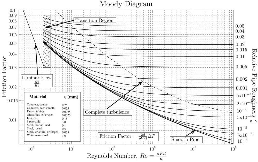

Friction makes all the difference here. If there is friction, however 'small' (see my remark below), then the tube can sustain a pressure drop, if there is no friction the tube simply cannot sustain a pressure drop if the flow is assumed to be in steady state condition.
Furthermore: the only thing that will apply a force on a fluid and thus either accelerate it or change its direction is the static pressure. Nothing else (except friction of course...).
So if you add friction this actually becomes a plausible case and you would get a linear drop of static pressure over the tube of exactly this 1000kPa by your definition (assuming the tube is long enough, because you also have some entrance and exit effects causing a pressure drop, if the tube is very short the pressure drop is not linear. But these entrance and exit effects are still mostly inside the tube). It will by definition be a pressure drop of 1000kPa because the two containers at the inlet and outlet of this are by your definition maintained at 1000kPa and 0kPa respectively. The flow will accelerate, increasing the friction which is dependent on velocity, until steady state is reached. This would not violate Bernoulli, rather it would violate the applicability of Bernoulli in this case. For Bernoulli to be valid you need frictionless flow.
Note that you cannot add 'a little bit of friction'. If you allow for friction then the flow will accelerate long enough until the friction balances the pressure drop exactly. However, the roughness of the internal surface of the tube will determine what the steady state velocity will be inside the tube.
If you however do not allow for friction, then the tube cannot sustain a pressure drop in steady state. If you insist both a pressure difference over the tube and steady state regardless, then you get a very weird theoretical discussion. If there is a pressure difference the flow will accelerate because there is a force imbalance. If the flow is to be steady state, there simply cannot be a pressure difference over the tube.
