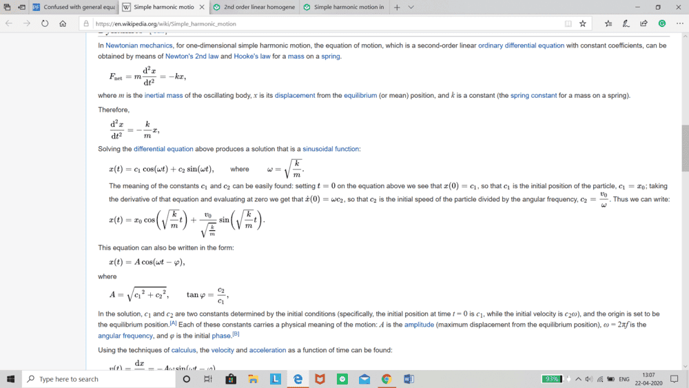

sir i have seen the derivation but that does not contain the omega term unless and until we take this assumption
Ah okay, then @PeroK 's right.
In any case say you didn't switch to the shorthand notation, you'd still get ##x=A\cos{(\sqrt{\frac{k}{m}} t + \phi)}##. It sort of makes sense that ##\sqrt{\frac{k}{m}}## has to be some sort of angular speed since that's what you get if you take the time derivative of the bit inside the ##\cos##! You could try increasing ##t + \Delta t## and showing that to go one more period you need a certain value of ##\Delta t## which has to be the time period, and this makes things a bit more concrete.
just check this out ...the solution of the differential equaltion came in the form of k/m...but it is only after the assumption that k/m=w^2 that we can see the w term in shm general equation
It's not an assumption.
Likes etotheipi
Start with ##\sin(\sqrt{k/m}\,t)##. At what time has the system advanced 1 radian? 2 radians? 3?
Now, if something has angular velocity ##\omega##, at what time has it advanced 1 radian? 2 radians? 3?
So what's the angular velocity of that first system where ##\sin(\sqrt{k/m}\,t)##?

Ok let's see, if you derive the equation of motion you get
$$\ddot{x}=-\frac{k}{m}x$$
wich has as general solution:
$$x(t)=A\sin{\left(\sqrt{\frac{k}{m}} t + \phi_0\right)}$$
Ok until here? Let's find now the period ##T##, that is defined as the smallest non-zero time that fulfils ##x(t)=x(t+T)## for ANY value of ##t## so, by definition
$$x(t+T)=A\sin{\left(\sqrt{\frac{k}{m}} t+ \sqrt{\frac{k}{m}} T + \phi_0\right)}=A\sin{\left(\sqrt{\frac{k}{m}} t + \phi_0\right)}$$
$$\sin{\left(\sqrt{\frac{k}{m}} t+ \sqrt{\frac{k}{m}} T + \phi_0\right)}-\sin{\left(\sqrt{\frac{k}{m}} t + \phi_0\right)}=0$$
Applying some trigonometric identities
$$2\sin{\left(\sqrt{\frac{k}{m}} \frac{T}{2}\right)}\cos{\left(\sqrt{\frac{k}{m}} t+ \sqrt{\frac{k}{m}} \frac{T}{2} + \phi_0\right)}=0$$
The only way this can be true for ANY ##t## is
$$\sin{\left(\sqrt{\frac{k}{m}} \frac{T}{2}\right)}=0 \Longrightarrow \sqrt{\frac{k}{m}} \frac{T}{2}=k\pi\Longrightarrow T = 2k\pi \sqrt{\frac{m}{k}}$$
Because we want the smalles non-zero time
$$T = 2\pi \sqrt{\frac{m}{k}}$$
This is the period, then the angular frequency is defined as
$$\omega = \frac{2\pi}{T}=\sqrt{\frac{k}{m}}$$
Likes vanhees71, Achintya and PeroK

Wow..nice .i understand it now
