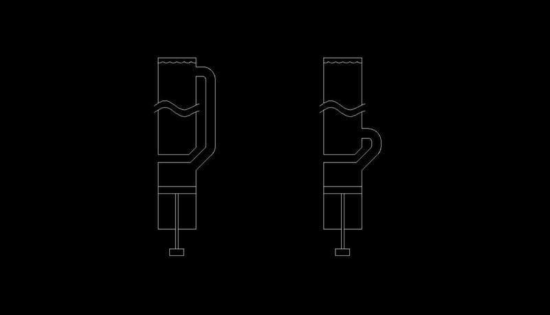

Assume two 4 ft diameter by 25 ft tall water tanks, both are equally filled to 23 ft. Both tanks have chambers of the same diameter as the tank attached below them. Each chamber has a piston and has 2 ft of water above their pistons. Both chambers have a 4 inch diameter hose going from their chambers and into the tanks. On one of them, the other end of the hose penetrates the tank at 3 feet above the chamber. On the other the hose penetrates the tank at 22 ft above the chamber.
My question is, which piston will require more force or is there any difference. I would also appreciate any explanation that you want to include.

Ahh.. Can you show a simple diagram? :biggrin:

I have added a diagram called Undrstnd hd.png in hopes of clarifying this question.
Big fat blank. Please try again. Always use the 'preview' button to check how your material displays before you post.
Sorry for the problem with the picture I attached previously. I’m having an issue with the latest update of DraftSight not exporting DWG files. Several of the formerly possible file types (.png, .tif, .wmf, .emf) create the file but they are not visible. So it seems the attached JPEG is visible.
Thanks
static pressure head at a point inside a body of liquid is given by ρgh , as Astronuc Stated, where h is the height of the column of water above the point of interest, think of it this way, if you have two paper cups filled to the brim with water, and you put a hole in each cup, one near the top, and one near the bottom, the water will flow out faster from the hole near the bottom , because the h is higher, ie the column of water is higher, hence the static pressure is higher. similarly, your piston with the hose near the base of the tank will experience greater pressure
