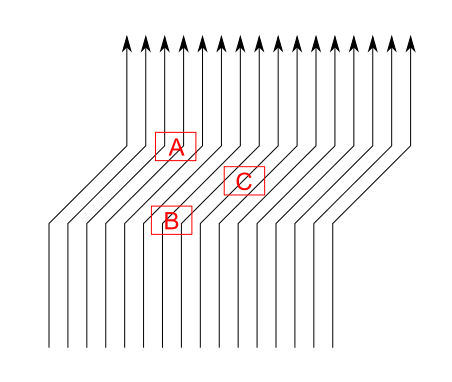

Below shows an image of the electric field with a kink in it as would be expected after a sudden deceleration. Clearly the curl at A and B is nonzero but the curl at C is zero. The curl of A is of the opposite sign of the curl at B.
According to the Feynman link I just posted above, this kink which is due to the acceleration of the charge, falls off as 1/x (think conservation of energy) while the electric field itself falls off as 1/x^2. When the electric field has fallen off so much as to be negligible this kink will still be there but will consist of electric (and magnetic) fields going around in circles (curl > 0). In other words it will be light.
Edit: This is actually the electric field of a stationary particle that suddenly moves and then stops again immediately but its enough to illustrate my point about curl.
I notice this diagram portrays radiation field components pointing only to the right. Of course, we cannot have EM radiation with a DC component. So other accelerations must have occurred, or will occur, so that the radiated waveform is balanced. The timing of these events (the initial switch-on etc), seems to dictate the lowest frequency component.
You don't seem to understand. The curl is the radiation. The curl is there but doesn't look like curl (doesnt look like field lines going around in circles).
The circular field lines only become visible after the electric field due to the charge becomes negligible
That isn't a sudden deceleration in the sense you were using it earlier. Rather, it's the result of a short period of deceleration. Furthermore, it's a snapshot of a small part of the field very far from the source (which is why the field lines are nearly parallel).
I think that answers @tech99's objection - the overall picture is one of radial field lines with a kink at radius ##c\Delta t##, where ##\Delta t## is the time since the deceleration and ##c\Delta t## is much greater than the width of the diagram. The above picture is an exceedingly zoomed-in diagram of a small part of the field.

To sum up: A charge experiencing a very sudden acceleration would emit very high frequency radiation.

I think the B radiation field is something a stationary observer sees as the electric wave passes. I am not sure about generation of the B radiation field by the kinking of field lines.
Not sure I understand your point. The "electric wave" occurs as the kinks in the E field pass and marks the edge of the B field. This is then an outgoing radiation pulse representing the frequency content of the acceleration pulse.

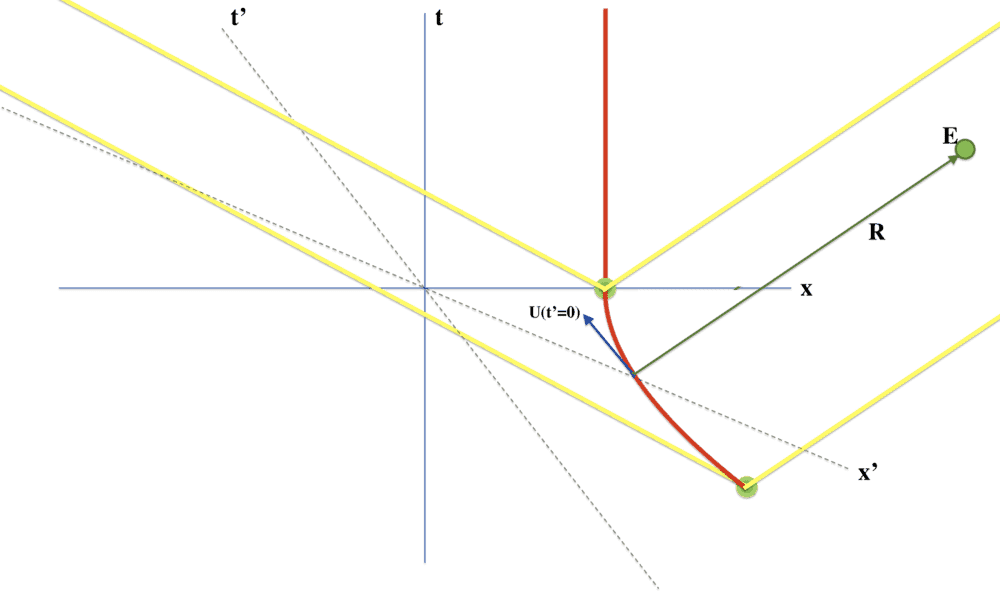

To try to begin to understand your method I drew a picture, I wondered if it agrees with what you had in mind (or whether it's completely off :wink:)? The red line is the worldline of the charge, and at ##t' = 0##, its 4-velocity is parallel to the ##t'## axis, so the charge is instantaneously at rest at this time in ##S'##. Also, the vector ##R## joining this event to ##E## is null, and thus parallel to the yellow lightcones.
How does that look?

That's it. Thanks - I was planning to draw a Minkowski diagram myself, but got side-tracked with the simplification stuff.
Looking at that, I wonder if I've got the wrong sign on my solution for ##v##, since it should be negative. I'll have a look tomorrow.
