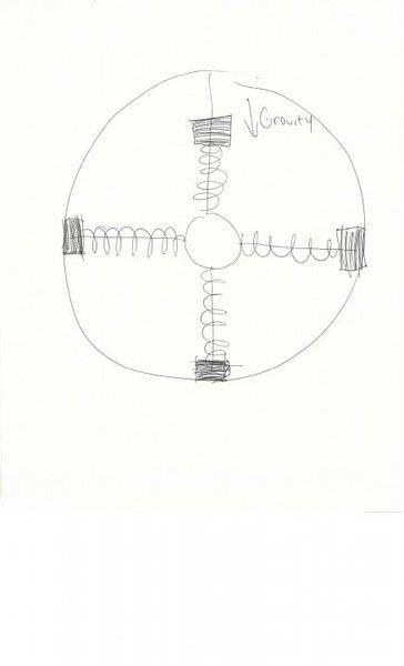

Good afternoon and thank you all that helped with the other wheel. It did in fact loose energy from the slide as the position once the movement happened, the energy was lost as the leverage was lower once the movemnt happened and therefore not recoverable.
Which leads me to this wheel and question.
As the wheel rotates, very slowly as to have a minimal centrifugal centripetal force affecting it, the weight in the 10 through 2 o clock position will compress the spring, as the wheel rotates further the spring un-compresses and pushes the weight back to the outside of the wheel.
Question - Does this wheel require more energy to turn when compared to the identical wheel moving at the same speed (rpm) with the weights fixed to the outside so they can not move?
My thoughts, no, since the energy (leverage) is lost at the top but stored in the spring and recovered on the other side as it goes back down. I am wondering if there is energy loss due to the compression of the spring, loss of leverage temporarily.
Thanks for any input. I understand these are pretty mundane questions and all revolve around Newtons laws of thermodynamics but some clarity or guidance and confirmation would be great.

You do not lose energy to "leverage".
As I wrote in the previous thread, the only discrepancy between the effort required to turn the wheel with a simple mechanism and the effort required to turn the wheel with a complex mechanism must be due to irreversible effects. Friction free slides, ideal springs and rigid levers on ideal bearings do not suffer from irreversible effects. Accordingly, there can be no increase in effort required.
As others wrote in the previous thread, in the real world, no mechanisms are perfect. You will suffer from irreversible losses. In general, the more complicated the mechanism, the worse the losses. But do not look for those losses in leverage. Look for them in friction, vibration, impact and air resistance.
Likes cameron1 and russ_watters
Due to conservation of energy, any quality built wheel will require approximately zero energy to turn.
regardless to what happens inside the wheel? My understanding is the same, almost zero energy to "turn" the wheel once it is up to speed, minus bearings, wind and friction. My focus is on what happens to a weighted wheel, is that still the answer, because it is a wheel and whatever happens on one side must counter act on the other side...
The energy to turn the wheel stays the same regardless to what is happening inside the wheel.

It depends on what happens inside the wheel certainly. The hopper on a rotary cement mixer takes energy to turn because the blades and paddles turn the mixture and viscous friction dissipates the input energy. Let the cement harden and it takes no energy to turn (though will be badly unbalanced).
If there are no dissipative losses then mechanical energy is conserved. One need not even consider what happens on one side of the other. Mechanical energy is (except for such losses) conserved regardless.
This is very close to a rules violation on the grounds that you are describing a perpetual motion machine. The fact that you are running it in reverse is the only thing saving you.

Strictly speaking, what you've designed here is a wheel with a lower moment of inertia than if the weights were fixed to the outer edge. So you'll actually have an easier time accelerating and decelerating the wheel -- at low speeds. At high speeds, the weights will be pushed out to the edge anyway by centrifugal effects. Interestingly, the same can be said of your previous wheel design: that one would actually dissipate energy, so it would require a constant input to keep moving, but again, that effect disappears at high speeds due to centrifugal forces.
How does the lower moment of inertia affect the total energy input to bring the wheel up to a certain (large) speed? At low speeds the moment of inertia is lower, and at high speeds it's the same as in the fixed-weight case; since it's never greater, it seems as though the total energy input might be lower. But my mathematical intuition is that it should turn out the same either way; after all, the end product looks the same. Still not sure how to justify or refute that without some calculations.

One of the useful bits about energy conservation is that it allows you to skip right past the messy calculations to the result that you already know must be true.

No. Energy is required to accelerate it, but not to turn it at constant speed. Newton's first law tells us that the force/energy required to keep an object in a state of constant motion (including rotation) is zero.
Again: if there are no friction or other such losses, the energy required to turn the wheel is zero.

This thread has correctly concluded that conservation of energy is alive and well. I think we can arrive at the same answer another way.. After one revolution the system is back where it started even if the masses have moved on some complicated path in the meantime. However gravity is a conservative field so work done is independent of the path.
https://www.google.co.uk/url?sa=t&s...3PwIoJtLz6TUnrQ4g&sig2=gFpH6kjoZclTbZINkGAXSQ
So no matter how complicated the path if it ever returns to the starting position the work done will be zero.

No need for one revolution, just one quarter revolution and the system will look the same
The point is that if it ever returns to an equivalent position at that point the net work is zero. As that's effectively the definition of a conservative field.
If it never returns then fine but I think it would be hard to build a practical machine that did. For example you can't keep accelerating a flywheel indefinitely.
