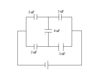

Find the equivalent capacitance of the picture in the attachment file
Circuit diagram with a battery at the bottom and five capacitors in a bridge arrangement: 3 uF top left, 5 uF top right, 6 uF in the middle, 2 uF bottom left, and 3 uF bottom right.

The circuit is neither in parallel or series. I tried breaking it up into series and parallel but it seem too easy to be correct. Any tips on solving this?
Since the circuit capacitances are not symmetric, you may just need to do it the brute force way, and write the KCL equations.
