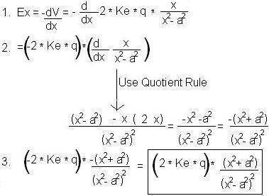

I understand the concept of this, and have calculated V, which is [ (2*(Ke)*q*x) / ((a^2) - (x^2)) ] and i know how to start the problem of Ex...
Ex = - (dV/dx) = - [ (2*(Ke)*q*x) / ( (a^2) - (x^2) ) ...
But I can't remember or figure out for the life of me how they got
= - 2*(Ke)*q * [ { (a^2) + (x^2) } / { ( (a^2)-(x^2) )^2 } ]

yes that is correct :D.. but i already got past that point and found the answer for the electric potential, V ... which was the sum of that equation...
and got (2KeqX) / ( a^2 - x^2) But that just gives me the potential... I needed to take it a step further and find the magnitude of the electric field from that... which is Ex ... which is = -dV/dx ... but i don't see how they derived the answer ...

Is your problem that you don't know how to take the derivative?
You have to your the quotient rule!
Sorry, I mean : You have to use the quotient rule!
Quotient Rule
Please see the attached file. You will see how the quotient rule is require to get that answer.
