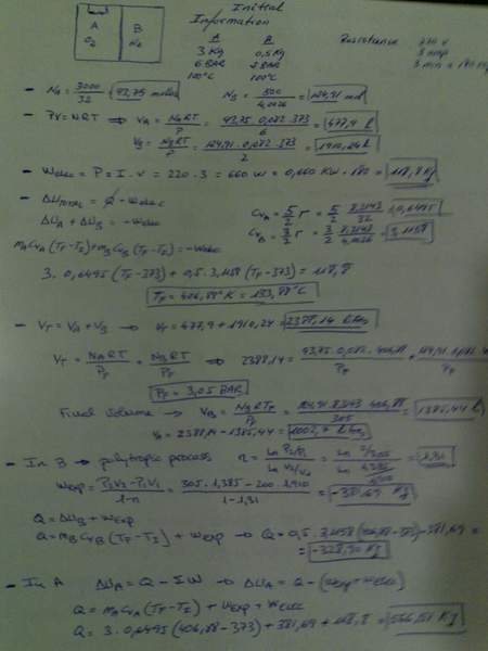

If you don´t mind I`m going to write all exercise and like I solve it.
Have a rigid and thermally insulated tank having a diatermano piston that divides in 2 separate parts. Part A contains oxygen and inside there is a resistance connected to 220 v which supplies a electric current of 3 amperes. The other part B contains helium. Initially the system is in thermal equilibrium.Oxygen mass is 3 kg and 6 bar pressure.Helium mass is 0.5 kg, their pressure 2 bar and 100 º C. Temp. We turn on the resistance for 3 minutes while freeing the piston.In B there is a polytropic process. The gases are perfect.
Answering a) P, T, V start and end in A and B
b) Flow of heat and expansion work exchanged by both chambers
a) First I calculate moles in A (93,75 mol) and in B (124,91 mol).
Like the system is in thermal equilibrium [itex]T_A=T_B[/itex] then by [itex]PV=NRT[/itex] I calculate [itex]V_A=477,9 Litres[/itex] and [itex]V_B= 1910.24 Litres[/itex] Now I calculate
[tex]W_{elec}= P= I . v= 220 x 3 = 660 W=0,660 Kw x 180 sec = 118,8 Kj[/tex]
Then [itex]\Delta U_{total} = -W_{elec}\rightarrow[/itex] Then [tex]m_A Cv_A(T_f-T_i)+m_B Cv_B (T_f-T_i)= -W_{elec}[/tex] I calculate [itex]T_f= 406,88ºK[/itex]
To Calculate final pressure : [itex]V_A+V_B= V_T[/itex] I calculate [itex]V_T=477,9+1910,24=2388,14 Litres[/itex]
Like the total volume is constant
[itex]V_T= \frac{N_A . R. T_f}{P_f}+ \frac{N_B .R .T_f}{P_f}[/itex]
[tex]2388,14 = 93,75 x 0,082 x 406,88/P_f + 124,91 x 0,082 x 406,88/P_f[/tex]
Then [tex]P_f= 3,05 Bar[/tex] and Final volume in B is [tex]V_B = 124,91 x 8,3143 x 406,88/305 = 1385,44 litres[/tex]
And Final volume in A is [tex]V_A =2388,14-1385,44 = 1002,7 litres[/tex]
b)To calculate heat and expansion work flow
[tex]\Delta U_B=Q-W_{expansion}[/tex]
we know is a polytropic process and we need calculate polytropic index
[tex]n = \frac{Ln (P_B/P_A)}{Ln (V_B/V_A)}=1,31[/tex]
After [tex]W_{exp}= \frac{P_2 . V_2-P_1 . V_1}{ 1-n } = -381,69 Kj[/tex]
I`m sorry I have problems with Latex code and I don`t know why.I`m going to finish post by attachment.Thank you.[tex]\frac{}{}[/tex]
Hello again, here is the exercise,do you think is ok?. I ´m sorry to send it by attachment. I will try to solve my Latex problem.Thank you for your help.
