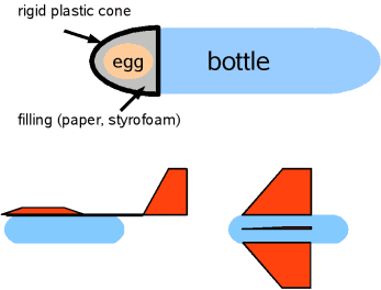

Hi, we are doing a project in school where we have to launch a water-rocket at 45 degrees and get it the furthest distance from the launch pad with the 'egg-stronaut' still intact.
Here is my idea. We make the wings in the shape of a glider, similar to the shape of the space shuttle's wings and add a crumple zone into the nose cone so that it absorbs most of the impact in the case of a bad landing.
The thing is that I am only a high school student and have no idea of where to start to calculate the wing size/surface area/shape. The rocket is a standard 1.25 litre coke bottle and will be filled with approx.420ml of water. can you provide me with the details to create wings of the right size so that the rocket can land at an adequate/safe speed and glide the furthest distance. This is due in 1 week so please answer quickly.
P.S Post any other suggestions you may have. More than 1 way to skin a cat they say, and i may be completely wrong so correct me if I am.

An simpler configuration might be just four big delta fins at 90° (like a glide bomb). Then you don't have to worry about rolling stability. Here what I would try:
Why don't you stick the aerodynamics to the egg itself (inside one of those cups), then the bottle is basically just a device to get the egg as high as possible? Once the thrust runs out the bottle and egg will fall separately, so if you put some decent wings and a nose/tail on the egg, it should hopefully glide a lot further in the right direction.
Yeah, I was thinking about making it like a glide bomb. I would buy a spare wing for the plane in the picture below (because I used to own one and know for a fact that it glides well enough), cut it to size and glue to my rocket. Tthis would be more like a http://en.wikipedia.org/wiki/HOPE/HOSBO" glide bomb.

The bottle + egg might be heavier that this plane, so you will need more speed. The transition to glide flight without stalling might be critical here. Can you use angles lower than 45°

I think your going to end up ripping the wings from bottle during thrust. You could buy the wing, cut it in half hinge them so they pop out at 90 degrees from the fuselage of the bottle. Kind of like when a fighter plane untucks it's wings when it comes out of mach, to make it more stable at slower speeds. If you use a strong elastic band and some kind of clip to keep the wings locked while it lands it should work. You might need to attach some fishing wire to release the mechanism, then tie the wire to the ground. when the bottle gets a certain distance the wire goes taught and pulls the release mechanism, the wings then pop out and lock in place and the bottle can glide down.
