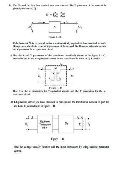

my problems comes from one of a book how to solve this one this is regarding with two port electrical network
  • Textbook page of two-port network problems: a block diagram of four-terminal network N1 with Z-matrix, a transformer circuit Figure 1-C, and a T-equivalent cascade block diagram Figure 1-D with load RL.

For Z parameter
[tex]\left(\begin{array}{c}V_1\\V_2\end{array}\right)\;=\;\left(\begin{array}{cc}Z_{11} & Z_{12}\\Z_{21} & Z_{22}\end{array}\right)\;\left(\begin{array}{c}I_1\\I_2\end{array}\right)[/tex]
[tex]V_1=Z_{11}I_1+Z_{12}I_2[/tex]
[tex]V_2=Z_{21}I_1+Z_{22}I_2[/tex]
[tex]Z_{11}=\left(\frac{V_1}{I_1}\right)_{I_2=0}\;\;,\;\;Z_{12}=\left(\frac{V_1}{I_2}\right)_{I_1=0} \;\;,\;\;Z_{21}=\left(\frac{V_2}{I_1}\right)_{I_2=0}\;\;,\;\;Z_{22}=\left(\frac{V_2}{I_2}\right)_{I_1=0}[/tex]
For I=0 means open circuit.
For Y parameter just (I)=(Y)(V) and make one of the V=0 which is short circuit.
For transformer it is reciprocal circuit so Z12=Z21 and Y12=Y21.
I have not work out the detail, just use this on the transformer and it should work.
thanks for your answer.but consider this
the circuit is reciprocal so that[y][/21]=[y][/12] , Am I right?
