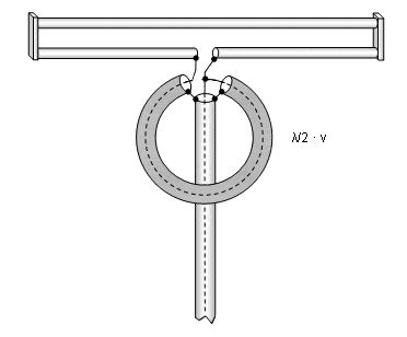

Hi, I'm building a Yagi antenna for the 440Mhz ham band. The outline I'm following uses a driven element of a folded dipole; Z = around 288 ohms. I am feeding this with 50 ohm source. Many internet sources describe a balun made from a 1/2 wave length coax (velocity factor adjusted). I will reference here http://www.ece.mcmaster.ca/faculty/nikolova/antenna_dload/labs/Exercise1-5.pdf page 1-77 where the balun is described. Now I follow that the voltage is doubled as we extend the transmission line 180 degrees down the line. But I'm really confused about the current paths of this. It seems that the I of the center conductor is all that is used to supply the antenna (load); and further as the coax shields are all tied together and not connected to the antenna at all - where is the coupling for the current that travels back to the transmitter on the shield of the coax? I had fields 30+ years ago, and antennas still mystify me, but I'm not seeing this. Can someone explain this?
Think of the half wavelength transmission line section as a centre tapped (auto)transformer providing a balanced signal. It is driven on one side by the unbalanced feed line.
The differential voltage is symmetrical about the shield. The balanced secondary circuit is loaded by the folded dipole which has equal and opposite terminal currents, so there is no shield current in the folded element.
The differential voltage will be twice the centre conductor voltage to shield. If there is no reflected energy on the line, the current must be half, so the impedance will be 4 times.
Note; your reference, page 1-76, fig 1-48 is missing a shield link on the input line. It is shown correctly on the next page.
Baluncore, Thank you for your reply. I had originally thought of an autotransformer; but that works through the energy transferred via the magnetic coupling. There is no magnetic coupling going on here. The main reason the shields are tied together is so the center conductor does not radiate and allow the signal to extend to its 180 degrees to the -V providing the 2V signal (which then implies a 4:1 Z coupling) - this part I understand. And likewise I understand that the voltage is symmetric about the shield at the initial feed point. (BTW: the paper I referenced is not mine, it is one I found on the internet that provided a good math presentation for the center conductor and impedance. Which I had already understood) But, at the initial feed point where is the current coming from which travels back to the transmitter on the shield?

You can also think of the Half Wave transmission line as a non-radiating HW dipole. There will be a standing wave on the HW dipole. The HW dipole is driven by the feed line at one end, referenced to the braid attached at the mid-point. The ends of the HW dipole provide the symmetrical feed to the radiating element.

I'll throw in my 2 cents here. I think of it as a delay line. I find that for some reason it is easier to visualize it laid out in a straight line instead of the coax looped back as it is usually drawn and always positioned in the real world, but that cannot happen in reality since the shields need to be tied together closely. So we send a CW signal down the line and at the end of the line and 1/2 wave back from the end we have the same signal except 180 degrees out of phase. If we draw power from these 2 points ohms law tells us that it HAS to be operating as a 4:1 transformer since we have doubled the voltage compared to just a normally terminated transmission line.
Now with that out of the way, am I to understand that you assume the current is not the same in the center conductor as it is in the shield of the 1/2 wave section? I would believe this to be the case also. I had never thought of this before but I would assume that it does not radiate since it is folded back on itself. You will see stubs used to phase up antenna elements stacked on top of each other. They are 1/4 wave long with their conductors spaced closely connecting the upper element with the lower element. The same thing is happening here. Those stubs do not radiate either.
Yes, it is a delay line, but it is also a resonant element due to the impedance mismatches at it's ends.
A coaxial cable is really two transmission lines in one. Firstly, there is the internal dielectric and it's coaxial conductive walls. Secondly, there is an external transmission line, being the outside of the braid working against the Earth and environment. Those two lines can be treated quite independently.
Since all the coaxial braids are connected at one point in the balun there cannot be unbalanced internal currents. The centre conductor induces an equal and opposite current inside the braid. The unbalanced external line is unimportant in the analysis.

Ok, I see what you mean on the original post, the 'return' current path is through the EM field coupling inside the coax transformer and the antenna.

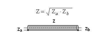

coax transformer:
Diagram of a quarter-wave transmission line transformer: Z = square root of (Za times Zb) above a grey cylindrical line labelled z, with endpoints labelled Za and Zb.

1/2 λ coax transformer feeding antenna:
Diagram of a dipole antenna fed through a coaxial balun: a horizontal dipole with two arms at top, connected to a looped coaxial section and a vertical coax feed line below, with the label N2 · V beside the loop.
