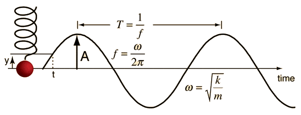

OK. I did a quick analysis of the problem, and came up with a first order approximation you can use to ballpark the release velocity. This is based on the method alluded to by AlephZero, and it is similar in form to the equation given by the Institute.
[tex]v = u_0\sqrt{\frac{k}{m}}[/tex]
where k is the spring constant, m is the mass of the spring, and u0 is the initial compression displacement. When using this equation, you need to employ consistent units.
See what kind of number you come up with using this equation.
Chet

You will have to state more precisely the problem you are trying to solve, as what you are asking is a useless information.
A spring stores energy. You can release that energy to do some work. If you just release the spring with no reaction force, what's the point ? The question you are asking - At what speed goes the tip of a released, unloaded, spring ? - is the same type of question as: If I short the two poles of a battery, what kind of current will I get?
The theoretical answer is an infinite current because we assume there is no resistance. For your case, it is the same answer as there is no "resistance", i.e. no mass coupled to your spring; So the theoretical speed that will reach the tip of your spring is infinite.
If we assume that one end is fixed, then the speed at that end is zero. This means that between both end, the speed can be anything between zero and infinity.
By dividing the spring into a succession of [itex]n[/itex] smaller springs (of the equivalent spring rate [itex]nk[/itex]), placed in series, which have their masses ([itex]m/n[/itex]) located at their free end, you can get an idea of the speed. The speed of the mass situated at the tip of the spring is:
[tex]v = n\sqrt{\sum^{n}_{i=1}\left(\frac{1}{i}\right)}\;u_{0}\sqrt{\frac{k}{m}}[/tex]
The larger is [itex]n[/itex], the closer you will be to infinity as the equation under the first squared root is an harmonic series if we set [itex]n = \infty[/itex].
To find the speed anywhere on the spring the equation is:
[tex]v_d = d\sqrt{ \sum^{n}_{i=(n+1-d)}\left(\frac{1}{i}\right)}\;u_{0}\sqrt{\frac{k}{m}}[/tex]
Where [itex]v_d[/itex] is the speed at a distance [itex](d/n)\;l[/itex] from the fixed end of a spring of length [itex]l[/itex]. Of course, if [itex]d=n[/itex], you get the previous equation (the speed of the free end).
Obviously, you will never reach an infinite speed in real life, just like you will not reach an infinite current by shorting two poles of a battery, because there are other resistances that you will never get rid of (like air friction for example).
All of this to say that if your spring doesn't do any work (like pushing a mass a lot larger than the spring itself), trying to determine its speed of deployment is a useless information and that is why nobody bother to determine it precisely.
