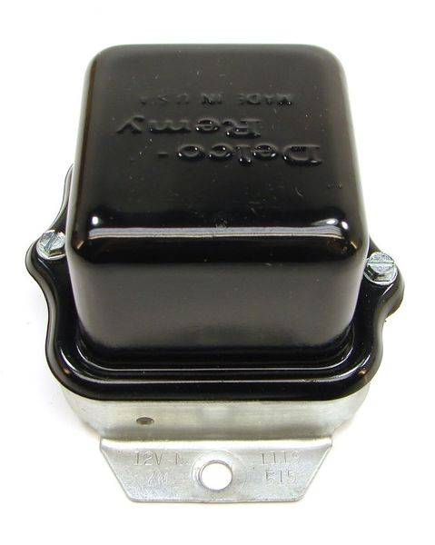

When you read a voltage higher than that when installed on an engine, you actually read the voltage produced by the generator/alternator. The voltage of the generator/alternator depends on its rpm. To make sure it stays constant, there is a voltage regulator installed on the generator/alternator output (today, the regulator is most likely incorporated within the alternator). The «true» voltage needed by a car electrical system is 14 V. All electrical components are designed to work at that voltage, because this is the voltage needed for recharging the battery as explained in previous posts. Therefore, the voltage regulator tries to maintain that voltage. When the voltage regulator exceeds 15 V, it is because it malfunctions.
Mechanical Voltage Regulator from a 60's GM car (was bolted on the firewall, apart from the generator/alternator)

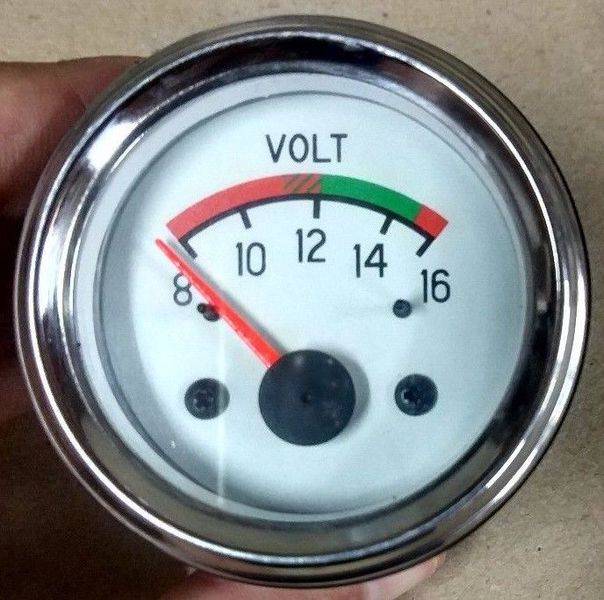

A typical electrical gauge. Note the green zone (12-15V), the «overload» zone (11-12V) the «undercharging» zone (<11V) and «overcharging» (>15V).
