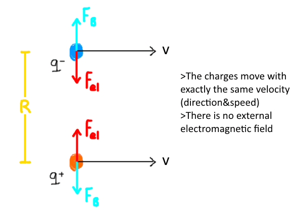

Consider two equal and opposite charges moving in the same direction and velocity v0, and are separated a distance R. There will always be an attractive electromagnetic force Fel=q2/(4πεR2), but when they are moving, they will produce a magnetic field B=μqv/(4πR2), and thus a repulsive magnetic force FB=Bqv.
I tried finding the velocity at which these forces are balanced;
Fel=FB
q2/(4πεR2)=μq2v2/(4πR2)
v0=1/√(ε0μ0), which turns out to be the speed of light.
I find this result very surprising; the forces will be canceled out when only the velocity is the speed of light, and the charge and distance can be anything. Does this mean like light has two very small charges with equal spins (1/2+1/2=1) and no mass and thus can interact electromagnetically?
Edit: Here is a picture to clarify what I mean.

Hi abro, welcome to PF!
This is a very interesting result, which I am glad to hear that you discovered on your own. It turns out that this is not a co-incidence, but is a reflection of the fact that magnetism can be seen as a consequence of the combination of Coulomb's law and relativity:
http://physics.weber.edu/schroeder/mrr/MRRtalk.html
In relativity there is a phenomenon called time dilation, which means that a moving clock ticks more slowly than a stationary clock of the same construction. If you have two charges at rest and they attract each other through some force then you can use that as a kind of clock which "ticks" when they collide. In a frame where they are moving they "tick" slower due to relativity, which is interpreted as a magnetic field opposing the electrical force and thereby reducing the net force.
I would point out that since they are moving in the same direction and speed, that we know already that the magnetic field is not going to have a net effect at that instance. If we observe in the frame of the charges, so that they are stationary, then there is no magnetic field, just the coulombic field. So whatever force we see from magnetic field in a lab frame should not affect the net attraction. If we get a magmetic force that affects the charges, then there must be an associated change in the electric field. This can change once we allow the charges to move towards each other.
This all ties into what Dalespam has already stated above.

But the net force is not the same in the lab frame. Kinematically, it cannot be the same due to time dilation and length contraction. Forces are not invariant.
Dynamically, the magnetic field given by Maxwell's equations is the force which ensures that the kinematics work out correctly. The magnetic field does indeed exert a force on the charge and that force is the required force to "correct" the electric force relativistically.

Normally, relativistic effects are important only at high velocities. The magnetic field is an interesting example of where relativistic effects are important even at low velocities.
The "order" of the relativistic corrections are not any different mathematically. It's just that the electric force is so strong that the tiny relativistic corrections are noticeable.
That's impossible, everyone has to agree on the fact there's a force acting on them.
Everyone does agree that there is a force acting between the charges. What they don't agree on is whether the force is purely an electric force, or whether the force has both electric and magnetic components.
The force is called the "electromagnetic force" precisely because of this ambiguity. Everyone who uses the appropriate relativistic transformation laws for the force agrees on the magnitude of the force. What they don't agree on is whether this force is purely electric or whether the force has both electric and magnetic components.

Your math and reasoning are both correct. If you assume that the charges are moving at c then the net force is 0, and everyone has to agree whether or not the net force is 0. Therefore the assumption that the charges could move at c must be incorrect.
Due to relativity the charges can move very fast, arbitrarily close to c, but cannot reach c. So the invalidity of the assumption is consistent with relativity and what we know of the laws of physics.
Note that at any speed less than c the net force is attractive, and everyone agrees on that fact.
