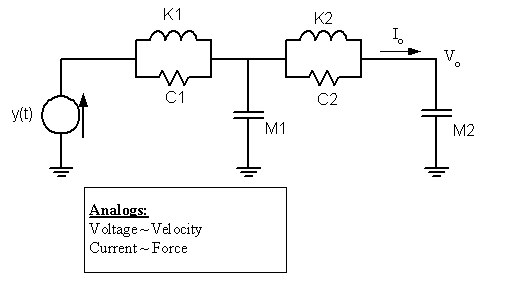

You have two equations and two unknowns (x1 and x2). You can solve for them as functions of m1,m2,c1,c2,k1,k2, and y.
(I would use the Laplace transform, but there is of course a time-domain way to solve them also. I don't have that info on hand.
Your mechanical system can be modeled as an electrical circuit (an "analog" system). Use a simulator (Spice) to characterize the maximal force versus various "input signals".
Assuming that voltage represents velocity and current represents force, the mechanical elements have particular electrical analogs:
Spring = Inductor
Damper = Resistor
Mass = Capacitor
Force = Current
Velocity = Voltage
Force inputs become current sources. Initial velocities (of masses) become initial voltages on capacitors. Velocity inputs are okay -- they become voltage inputs, so if you want to determine how your system responds to a given motion driving it, characterize the motion in terms of its velocity.
Electrical circuit schematic of a two-degree-of-freedom mechanical analog: voltage source y(t), inductor K1 in parallel with resistor C1, capacitor M1, inductor K2 in parallel with resistor C2, capacitor M2, with current Io and voltage Vo labelled, and a box listing analogs: voltage ~ velocity, current ~ force.
In the above circuit Io represents the force that's applied to the mass M2.
  • Circuit schematic of an electrical analog of a two-degree-of-freedom mechanical system. A source y(t) feeds K1 with C1 in parallel, then a shunt capacitor M1, then K2 with C2 in parallel, then output Io and Vo to capacitor M2. Box at lower left lists analogs: Voltage ~ Velocity, Current ~ Force.
