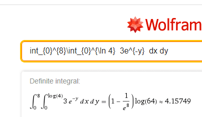

Ackbach said:
Check your answer on Wolfram|Alpha or Wolfram Development Platform with this command:
Code:
Integrate[Integrate[3*Exp[-y],{x,0,Log[4]}],{y,0,8}]
ok well I already had it in latex...
well how come its not 18
