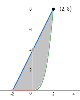

attempted plot
just seeing if I am going in the right direction with this
no book answer?

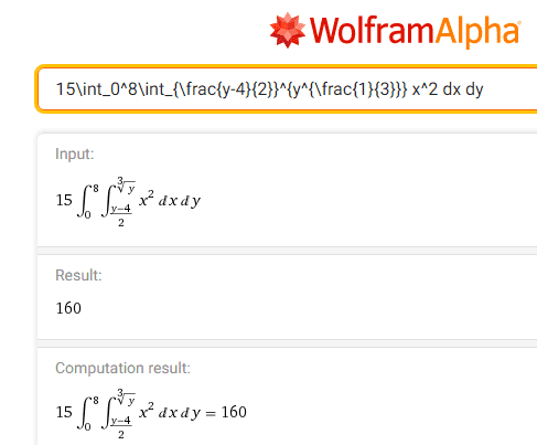

ok well this expands to via W|A:
\begin{align*} \displaystyle
&=5\int_0^8 -\frac{y^3}{8}+\frac{3y^3}{2}-5y +8 \quad dy\\
&=5\biggr[-\frac{y^4}{32}+\frac{y^3}{2}-\frac{5y^2}{2}+8y \biggr]_0^8\\
&=5 \biggr[-\frac{8^4}{32}+\frac{8^3}{2}-\frac{5(8)^2}{2}+8(8) \biggr]\\
&=160
\end{align*}
