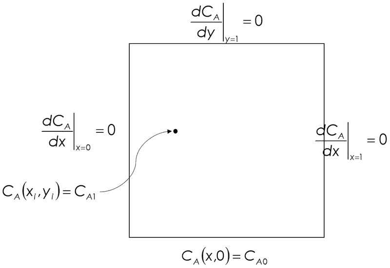

Hi. I have this problem in trying to solve this PDE analytically.
The PDE is represented by this diagram:
Basically this is solving the Laplace equation with those insulated boundaries except it has that point diffusing its value across the plane. I know how to solve the Laplace equation part. The problem is that I do not know how to solve the Laplace equation WITH a single point in there located at point (xi, yi).
While I have no problem in trying to solve this using numerical analysis, I am totally clueless how to solve this analytically. Where should I start? What should I do?
It seems you are asking too much. The solution is uniquely determined by the boundary conditions. Once found a solution you can check if it is consistent with the value you have at ##(x_i,y_i)##.
What?? How could it be asking too much?
I said it clearly I guess. I don't know where to start at all. If that point CA1 located at point (xi, yi) had not existed then obviously the solution for the PDE is just CA0.
I have no idea how to incorporate that point diffusing its values everywhere on CA0 that's why I'm asking.
Apparently this is Laplace equation with a dirac delta function on a certain coordinate. So apparently this involves Green's functions.
Who is this Green? Help?
Let's sneak up on it. Suppose that, rather than being in a small finite domain of a square, the system were infinite in extent, and, rather than the concentration being CA1 at a point, it would be CA1 on a small circle of radius a. And suppose that, far from the circle, at infinity, the temperature would be CA0.
Chet
I suggest you write the eigenvalue equation$$\Delta\phi+\lambda\phi=f$$where f is the diffusion function. First solve the homogeneous equation$$\Delta\phi + \lambda\phi=0$$by separation of variables and use the boundary conditions to find ##\phi_m\left (k_xx\right )## and ##\phi_n\left (k_yy \right )## and ##\lambda_{mn}=k_x^2+k_y^2##.
Introduce a trial function$$ \phi\left (x,y\right )=\sum_n\sum_m A_{mn}\phi_m\left (k_xx \right )\phi_n\left (k_yy \right )$$
and substitute in the equation$$\Delta\phi+\lambda_{mn}\phi=f$$
Multiply both sides of the equation by ##\phi_m\phi_n## and integrate to solve for ##A_{mn}##.
Thanks for the replies. But I gave up trying to get an analytical solution due to time constraints and killed the problem using a numerical attack. Lol
