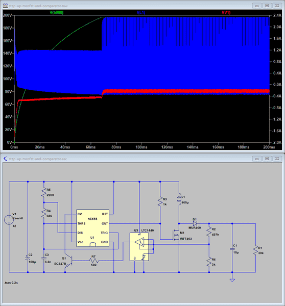

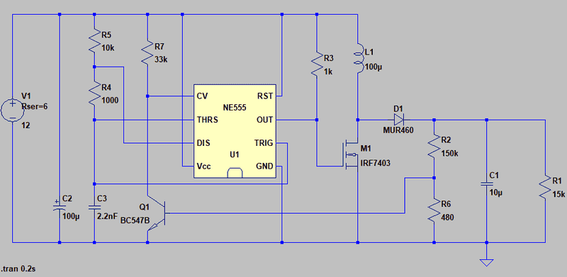

So, I needed DC-DC switcher, capable of delivering up to 200 V and 10 mA. Idea is simple - coil, interrupting the current, "collecting" the voltage. Easy to implement with 555, but difficult to control the output voltage with just frequency and duty cycle of oscillations. Some googling (this is switcher for a Niхie clock and I am not a first one to build it) yields this solution (element values can be different and actually R6 is a potentiometer allowing to control the voltage on the load R1):
What I don't like about it is that the output voltage depends on both the V1 voltage and R1 resistance. But I liked the idea of using CV (AKA CON) to change the duty cycle, so I decided to try a bit different approach, with a voltage reference and comparator:
In theory VOUT should not depend on the load nor VCC. I tested a very similar circuit in the LTSpice:
(it is not identical to the one I build as I couldn't find LTSpice models for LM393N comparator nor KA431LZ voltage reference, so I used a functionally equivalent chip from the program library). Green - voltage on the load (VOUT), red - current drawn from V1, blue - current through L1.
Long story short - it works not only in the simulation, but also on a breadboard. I have built a prototype and it powers my clock right now. No elements get hot, voltage looks stable (it is at 162 V now, and floats by about ±0.2), it does change a bit with load and VCC, but I have not yet tested it too heavily to see by how much.
Comments welcome.

How quickly can the load presented by the clock display change? One key to verifying switcher design is to present worst-case AC loads to the regulation and compensation circuit. I'm guessing that the display load won't change more than 1/sec or 10/sec, right? Probably the compensation can keep up with that. What is your switching frequency?
This is a four digit clock so the load changes just once per minute (I have no more Niхie tubes, these are large ones, rather expensive). 555 works at about 35 kHz (can't remember precisely). Initially I tried 1 μF C3 and the simulated output voltage was oscillating, so I replaced C3 with much larger one (that in turn means it takes about 0.1 sec to get to the desired voltage, but I don't think it is a problem).

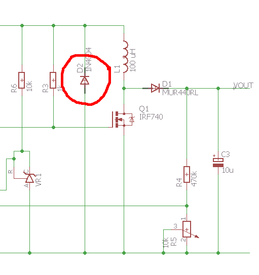

Glad you got something up and running. I would recommend a diode across the power supply. Specifically from the top side of L1 to ground. This prevents developing a reverse polarity from occurring in the event of losing the low voltage supply. C2 should help prevent this but just to be safe I would put a diode in. I would also add some power supply bypassing capacitors physically very close to the top side of L1 and the GND node on the MOSFET. When the switching occurs you want as short as possible leads to good low ESR/ESL capacitors.
Thank you for your comments.
That's what you mean, right? Not exactly across the power supply, but it was convenient to put in on the schematics close to L1, to keep things close to your description.
I understand it is one of those things you add "just in case" - rarely needed in reality, but a good practice to stay on the safe side?
Can you elaborate? Apparently either my English or my understanding of circuits (probably both) fails me as I am not sure where to put these capacitors. I understand the general idea of adding C to smooth out the ripples, I just don't understand where to put it in the case of the MOSFET (the L1 one should be in parallel to the just added diode, right?). And we are talking about 100 nF, just like the ones typically added around ICs?
Should I add another 100 nF capacitor near the 555? That's what I intended to do at first, but as there is a large C2 (intended to help supply the high current for L1, the 12V power supply that runs whole clock is rated 1A) I thought it might be not necessary. Edit: after some more thinking yes, I should.

Hello again Borek. Some folks would consider power supply bypassing capacitors to be a black art. When you stop and think about though, what is really happening is that the copper traces on circuit boards are actually small inductors. This is of little consequence at lower frequencies. But as the frequencies involved increase this inductance can become significant. Granted that 35 khz may not be a very high switching frequency but it will likely contain a lot of harmonics.
Add the cap or caps in parallel with the diode that you added. When you place appropriate bypass capacitors physically very close the the inductor and MOSFET on your circuit board you no longer have the effects of the longer circuit board traces acting as inductors.
In the past I have found digikey will have a nice guide in power supply bypass capacitors selection. I realize you may not order your parts from the USA but you can certainly exploit their website to select appropriate parts. www.digikey.com.
Keep in mind that the 100 uF cap you have may not look like a cap at frequencies that are harmonics of 35 khz. My rule of thumb would be to use a bypass capacitor or even several directly across the 555 as well.

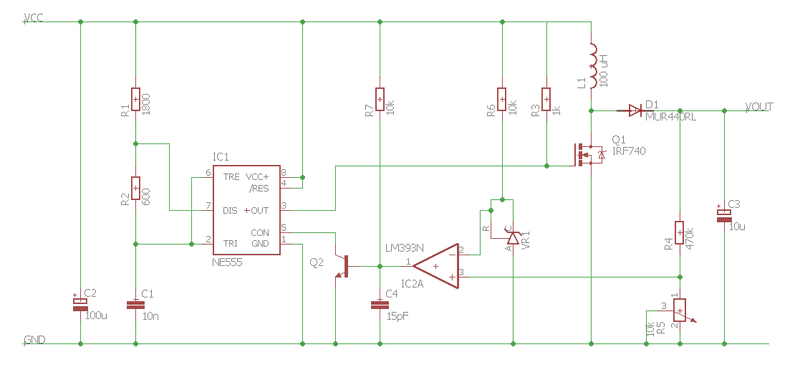

Sigh, the switcher worked perfectly well up to today (almost three weeks) - in the meantime I checked the temperature of elements several times, they were not even warm. Today while I started working on PCB to make a final, soldered version I smelled something burning - took me a moment to find out it was the MOSFET that got so hot it burned hole in the breadboard.
What would be your guess - problem with design, or I was just unlucky: the element was faulty, or some contact got oxidized and warmed up? MOSFET was switching currents in 1A range, so I can imagine some kind of a thermal runaway.
I thought I smelled something...
Can you post your final circuit and final control loop values? What load were you running with when the smoke got let out? Any chance you touched part of the circuit while it was running and caused EOS and latchup (not likely with a power circuit, but just asking)?
I am not sure what you mean by control loop values - R11 was tuned so that the CON was grounded through Q2 and switching the 555 cycle off when the VHIGH was 162 V.
The load @162 V was more or less the same all the time - in the 10 mA range (unless something strange happened, but the Nixie lamps, which are on another PCB are OK so it is rather unlikely they were source of the problem). The only large current is the one going through L1 and Q1.

Here is a detailed troubleshooting approach that may seem the wrong way around in spots. The specific sequence is intended to elicit as much information as possible about the root cause of failure without causing further damage. To track down the cause, please report the results of all these tests that you run; and anything else you may notice that gets your attention or are not sure of. Details matter in troubleshooting!
First a few recommendations. Either of the first two could be the underlying culprit:
1) R10 should be 1/2W due to voltage limitation of physically smaller resistors
2) C5 should be at least 250V
3) Add a 0.47μF, 250V metallized film capacitor across C5
The trouble was probably a loose connection somewhere, but here are some other possibles I can come up with at the moment are:
1) Defective Q1
2) Loose connection in Q1 gate circuit
3) Failure or loose connection in 555 circuit
4) Failure or loose connection in feedback circuit
5) Short circuit or overload on output
6) Q1 itself was oscillatingAt this point Q1 is obviously defunct so gently remove it from the circuit. Gently because we don't want to disturb other evidence. An approach to " gently" could be disconnect either end of the inductor AND either end of D1. Now use whatever means you have (hopefully a 'scope) to check that the 555 is oscillating, it should be.
Check for oscillation at the 555 timing components (pin 2, 6, or 7).
  • If no oscillation at the timing RC components
    • verify approx. 8V±10% at 555 pin 5.
      • If not ≅8V, disconnect Q2-Collector and check for oscillation again.
        • If oscillation, troubleshoot Q1 and Op-Amp circuit.
        • If no oscillation, replace 555 and verify there is oscillation.
      • Reconnect Q2-C and verify oscillation
  • If there IS oscillation at the timing RC components
    • Check oscillation at the 555 Output (pin 3), it should should swing between 0.25V and +12V (supply voltage.)
      • If there is little or no signal at 555 pin 3
        • Gently disconnect Q1 Source from Gnd
          • If present, check oscillation at Q1 Gate
          • If absent or low level, either 555 is faulty or there is an open connection around 555, R3, Q1-G
Replace Q1.
For initial testing, L1 can be replaced with a 470Ω, 1/2W resistor. This will allow safe testing for intermittents from parts of the feedback loop, the 555, and Q1. There won't be any output, so monitor Q1 Drain voltage.
If you can inject a controllable voltage at the R10-R11 junction you can also test the OpAmp, reference voltage, and Q2.
If you have a 'scope, check Q1 Drain for high frequency oscillation. It may appear as some fuzziness on the transitions of the switching signal or at the high or low voltage levels. If there is any high frequency stuff on the transitions, try putting a low value resistor (10Ω - 100Ω) in series with the Gate of Q1. This must be done with the shortest practical lead length between the resistor and Q1. Find the lowest resistance that stops the high frequency stuff then use a value 15% to 30% higher.
If there is high frequency stuff on the high or low voltage levels it means the gate bias is not swinging enough to respectively turn off or turn on Q1. I'll let you figure that one out!
Reconnect D1.
Once again, check for high frequency oscillation of Q1.
Remove the 470Ω resistor at Q1 Drain and install new L1.
Cross your fingers and see if it works.

2. I've had lots of trouble using fast comparators - they'll oscillate when changing state.
Here's a precaution from the TI datasheet at http://www.ti.com/lit/ds/symlink/lm393.pdf
Observe with 'scope the output of your LM393 ? Is it changing state decisively ?
If transitions aren't snappy and clean, a teeny bit of hysteresis might help .
A megohm or so between pins 1 and 3 ? Start higher and iterate toward value that gives clean switching but not excessive ripple in your high voltage .

One more observation ( academic interest only ) about that comparator
Working from a schematic it looks like positive feedback which is usually means trouble. But how your wires are physically routed determines whether that's really so.
Furthemore,
in your case i think that might well provide the positive feedback hysteresis loop this circuit needs albeit not quite instantaneously.
When you close a control loop by adding feedback all sorts of new possible behaviors suddenly appear... because what was just forward gain G becomes closed loop gain G/(1+GHfeedback) ,
i.e. a denominator appears
and if that denominator can be made zero you can rest assured playful Mother Nature will do so.
Figuring out closed loop troubles is a lot of fun..
I'm enjoying your adventure - thanks for sharing !
old jim

Also, I would add some positive feedback on that comparator.
To me, pulling the control pin to zero is running the device in undefined territory.
I agree with that. I searched TI datasheet for advice on minimum Vcontrol for reliable operation to no avail.
Old Signetics 555 timer datasheet is here, it's way more informative.
https://ia802706.us.archive.org/35/items/Signetics555556Timers/Signetics555556Timers.pdf
DISCH pin can probably pull TRIG and THRESH to around 0.1 volt
Don't know what is Vcesat for Borek's Q2, and i don't know how close to GND those comparator inputs will operate.
You're right i think - RESET might be a better way to stop oscillation.
from page 9 of old Signetics:
pull it below 0.4V.
I am in an undefined territory since I started playing with electronics last year. Actually I am often quite happy if I understand 50% of what you all write :nb)
If gated oscillations is what we are after then use the reset pin.
I believe I tried and it worked, I decided to use CONT pin as that was solution used in another 555 based switcher I have here (one that is quite popular between those playing with Niхiе clocks). As nobody pointed out any obvious flaws in the idea when I posted the schematic for the first time, I assumed it was not completely off.
Let people know if you don't understand, and they can prob give you a simpler explanation.
