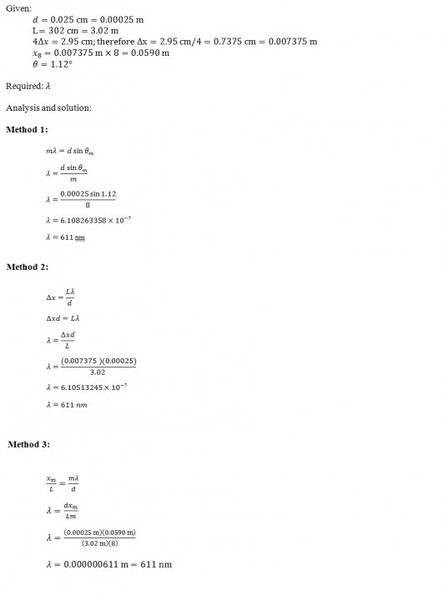

Upon using Thomas young’s double slit experiment to obtain measurements, the following data were obtain. Use these data to determine the wavelength of light being used to create the interference pattern. Do this in three different ways (6)
• the angle to the eighth maximum is 1.12◦
• the distance from the slit to the screen is 302cm
• the distance from the first minimum to the fifth minimum is 2.95cm
• the distance between the slit is 0.00025cm
I found 2 ways of finding the wavelength using the formulas
Change in x = L (Lambda) / d
and
m(Lambda)= (d)(sin Theta subscript m)
For my third method i thought about using the formula
m(Lambda)= (d)xm/ L
the problem is I was not given xm sincexm is the distance from a point on a antinodal line to the right bisector.
However, I was told by my friend that since the 8th antinodal is provided and that "change in x" is easily obtainable, xmcan be found by just multiplying the 2 together.
which would look like
change in x = 0.007375 (Converted to Meters from cm)
8th antinodal = 8
0.007375(8) = 0.059
therefore
xm= 0.059 meters
Is my friend right?
  • Typed worked solution showing three methods to find a wavelength of 611 nm from a double-slit setup, with d = 0.00025 m, L = 3.02 m, and angle 1.12 degrees.

Please define the variables you use. L, ##\lambda## and d are clear, what is everything else?
What is 0.059 meters? Certainly not the wavelength.
The third method has to be very similar to one of the other two methods, you don't have enough given values for three completely independent methods. Distance between slits and distance to the screen alone doesn't tell you anything about the wavelength, the given angle leads to one method, the given separation between minima leads to the second method.

Sorry, I was in a rush and I thought I attached my work when I posted. My work should be in the attachments now.
mfb said:
Method 2 and 3 are nearly identical, they just differ by a factor 8 in both numerator and denominator.
should I use a different one ?
See post #2: No matter what you do, two methods will look very similar. I guess the shown "third method" is as good as it gets.
