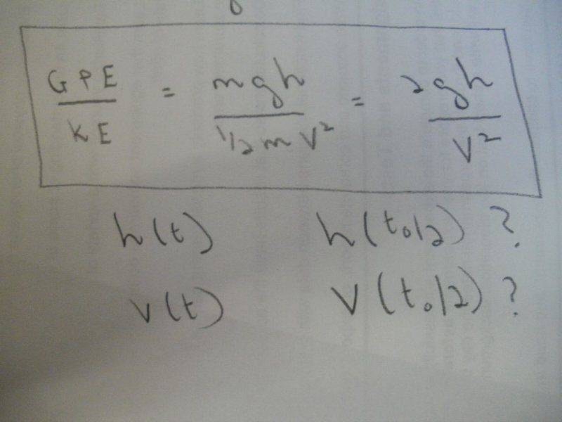

But how would I find the ratio between the two? Shouldn't I have divided the two?
Yeah, working in symbols would have made it easier.
So why don't you try that if it is easier?

I seems to get a ratio of 4:1?

4:1? The answer says it is 3:1.
In their working they have got (3/4) / (1/4). So the 4s cancel. I didn't get any of these numbers.

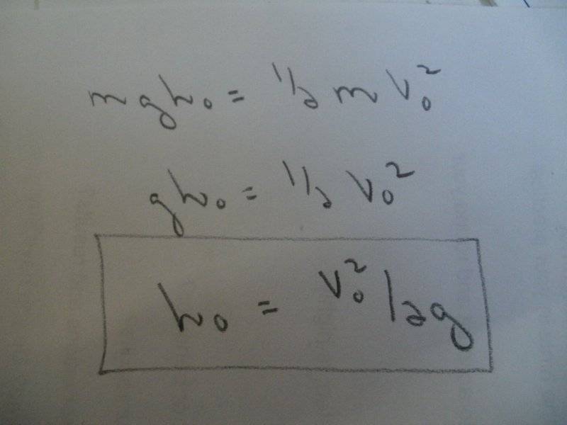

Note that the answer is independent of ##g##, ##m## and ##u## and, in fact, there was no need for any numerical calculations.
