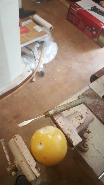

Exactly. I don't think the cue ball goes dead parallel with the cue, and I don't care 1° difference for now.
sophiecentaur said:
Even if there is slippage, the tangential force against the table will still be greater than with a horizontal impact.
How can you be sure that? You really push the friction between the ball and table... The cue angle would be always downwards in the game because there are rails, but we always try to strike horizontally as possible. So, the angle should be less than 5° in most cases. In my videos, I would say shots are very horizontal because there is no rail on my table.
Anyway, I am going to post probably decisive evidence against the friction between the ball and table. I hang a ball with a rope in the air and stroke the ball with right English.
I am sorry for the low quality experiment, but you would agree that the ball still goes straight without contact with the table.
So, now we can focus on the real force that makes the ball goes rightwards from the normal direction.
