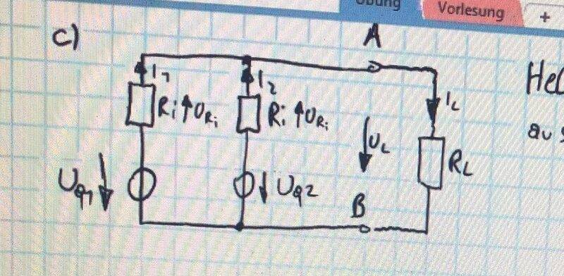

When a resistor R is connected, the terminal voltage of a battery is equal to
U = 4.3 V and the power in the resistor P = 2W. The battery is said to be ideal
Voltage source can be modeled with internal resistance.
a)What is the internal resistance Ri of the battery if its source voltage Uq =
4.5 V?
b)At which load resistance would the terminal voltage be U = 4 V?
cYou connect a second, identical battery in parallel. How does the power change from point a)? Draw the circuit and label all sizes.
P = UI
Okay so This is what I've tried;
a) A formula I've found in the lecture notes;
$$ U_a = U_q - R_i*I $$ To get I used the ## I = \frac{P}{U} ## formula I get I to be 0,46 A.Now put back in formula for and rearange to get Ri should be
$$ \frac{Ua-Uq}{I} = Ri $$ and the solution should be 0,43 Ohm.
b) I used the same formula as in the first one but here I simply rearanged to get I
$$ I = \frac{Uq-Ua}{Ri} $$ I = 1,16; and now ## R = \frac{U}{I} ## = 3,44 Ohm.
Now I think these two should be fine,I've checked the work with a few friends and it matches.
c) Here I am having problems.I've drawn the picture and I've tried a few things but I am not really having much succsses with it; This is my picture;(attachment) Now P should be 2,09W but I don't see how.What I've tried is adding both currents since they both are going in the same knot(above I2) and I Kirchoffs Law.With that new current,I've tried finding P but the value is not correct.Any insights? Thanks

What is the total resistance of the circuit?
I = Uq / ( Ri + RL )

Ah okay that I kind of overlooked.I've tried it again;
Now looking at your formula I think that the values of Ri and RL are simply the ones I calculated; so after calculating I again it should be I = 1,11 A . Now I think this should be the current of the circuit.Now to get the power of the entire circuit; P = U * I ;
Now this doesn't give me the wanted 2,09 W. I've also tried calculating the resistance of the circuit by considering that Ri are in parallel to each other but that didnt help. Could it be that the I i calculated is not what I think that it is?

Where did you calculate RL for a)?
Do you know how to use Kirchoff's laws, including a systematic method for getting the signs right?

For Part c), you haven’t shown your calculations but here are a couple of hints.
Hint 1: You must calculate the load resistance used in Part a).
Hint 2 (if you don’t want to use Kirchhoff’s laws): Two identical batteries, each with voltage source (emf) ##U_q## and internal resistance ##R_i## connected in parallel act as a single battery with voltage source (emf) ##U_q## and internal resistance ##\frac {R_i} {2}##.
So as I have seen just know I didnt realize that the RL in b and a was diffrent.My apologies. I did it just know and it should be RL = 9,25 Ohm.Now using the hint from Steve and this new RL I get the result I wanted (if we plug it into the formula I used earlier).But I am interested in the approach with Kirchoffs Law since we covered it in class and I think this is the way the exercise was susposed to be solved.I know both of them,but the systematic method for getting the signs right is kind of confusing.I am assuming you mean that if we sum up all of the voltages and the sign is negative than we just assumed the direction of the voltages wrong? So if I would to use the Kirchoffs Laws (which I would like to try it) I would need two loops and try to calculate the voltages out of that?

There are variations on how Kirchhoff’s laws are used, but all are equivalent. Have you tried any YouTube videos? This one is OK (plenty of others available):
For your circuit in Post #1, for the 2 loops I would choose:
1) the right hand loop (containing ##U_{q2}, R_{i2}## and ##R_L##);
2) the outer (perimeter) loop (containing ##U_{q1}, R_{i1}## and ##R_L##)
Note ##U_{q1} = U_{q2}##. And ##R_{i1} = R_{i2}##, though you have labelled them both as ##R_i##.
Have a go. Post your equations if you want them checking.
