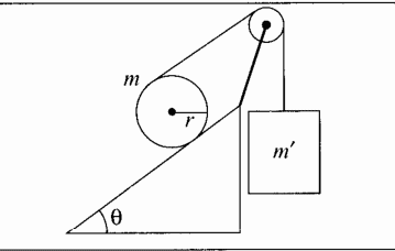

Basically, there is a gravitational field g and a friction force acting on the cylinder, which does not slip in the plane.
The question is, the acceleration of m'.
I solve this question basically by this:
" m*g*dh*sina + m'*g*dh = m*v1*dv1 + m'*v2*dv2 + I*w1*dw1 " {1}
w*r = v1' + v2'
So
The problem is, in {1} i suppose Δ U = - Δ T, until here okay, but i needed to say that:
Δ U = -(m*g*dh*sina + m'*g*dh)
I am trying to see why this is right.
Why not -(m*g*dh*sina) + (m'*g*dh) or +(m*g*dh*sina) - (m'*g*dh)
Maybe doing by the other ways, i would eliminate by absurds, or the first way already encompasses the case where one go up and another go down?

Well, dh is the distance traveled by the block hanging
v one is the velocity of the sphere
v two is the velocity of the block
I is the moment of inertia passing through the center of the sphere
w is the angular velocity
And using the fact that w1*r need to be equal to -v1, just substituting in the equation

If m' descends dh, how far up the slope as m move?
Same question, and check those signs.
Actually the second notation that you quote is a vector notation XD are the constraint that i found.
Lo = x2 + x1 - Theta*r
" If m' descends dh, how far up the slope as m move?"
I thought it far up dh too, but, it fall by R theta later, since it is routing. That is, as result:
-dh + dtheta*r (i adopt positive down the slope.)
Exact as it previous Lo = x2 + x1 - Theta*r
dLo = 0 = dh + x - dtheta*r
x = dtheta*r - dh

I assume x1 and x2 are movements by m (i.e. the mass centre of the cylinder) and m' respectively.
That cannot make sense as a vector equation since the constraint is imposed by the string, and the string changes direction between the two. Clearly these are just distances.
And down positive for the block too? Ok, that explains x1+x2.
It looks like you are taking clockwise as the positive direction for theta, right?
Lo, I take it, is the string length.
(It would save a lot of back and forth if you were to define all your variables in the first place.)
Since it is rolling contact, what is the relationship between theta and x1?
