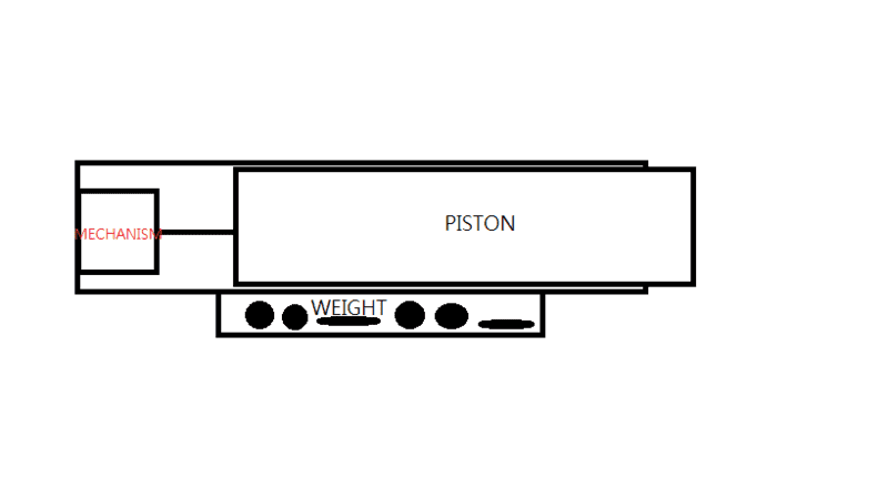

OK. after a few days of thinking , this is what I came up with:
the weight at the bottom of the device will set it's density to roughly 1 beforehand.
The mechanism at the left end of the cylider will be connected to the piston on the right with a bar of some kind. The mechanism, which contains all the elecronics/sensors will detect it's movement in the water with some sort of acceleration detectors. Then it will precisely pull/push the bar which will move the piston
to change it's volume.
Will this work? (please ignore the part of how should I charge the mechanism, this is just a rough draft)
ps: The connection between the piston and the cylinder is water/air tight
Will this work?
Looks to me like it should work just fine providing you can come up with an appropriate sensor/control mechanism to tell it when to move up and down. I have no idea if the accelerator you chose would work.
You will find it much more practical to use a pressure sensor for depth measurement.
To track depth with an accelerometer you will have to integrate all the changes of some very small signals over time. This is guaranteed to accumulate large and increasing errors over the time of a run. Realize also that your proposed diver will change orientation (tilt) depending on the relative position of the piston. So you will have to take account of all three accelerometer axis for each depth estimate. That calculation will likely introduce additional small errors, which will accumulate.
And how about using linear stepper motors to move the piston? What about that?
Sure; if you can figure out where there is room for the threaded rod with the piston retracted.
Ebay is littered with those small linear steppers (guess they are from some massacred ticket printers or similar). Good choice.
Ps.: just one thing. You will have a battery, electronics, and a motor. Why not use them as ballast? Put all those at the bottom of the standing tube, and then it'll not tilt. You can add external weight later on to the bottom outside if it is not enough.
Actually, perhaps just letting it be like this will be fine.
