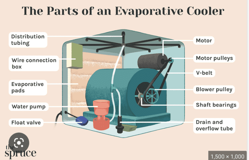

I was thinking of swamp coolers when i wrote this:
Evaporative cooling is also evaporative humidifying.
I have seen these in fish farm greenhouses. They use a plastic mesh or matting of some kind (common on fish farms) with water running over them and a big fan blowing air through it. They can be pretty primitive and still work.
