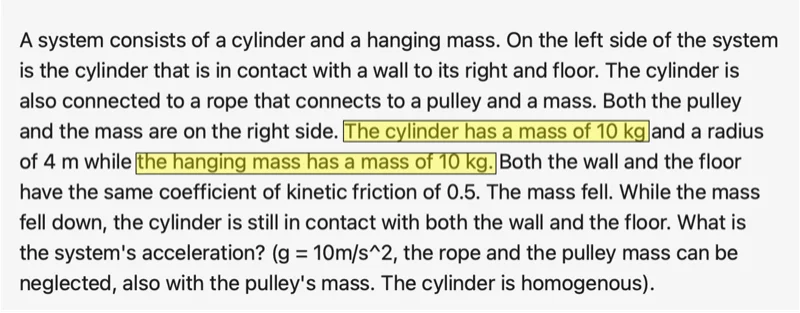

A system consists of a cylinder and a hanging mass. On the left side of the system is the cylinder that is in contact with a wall to its right and floor. The cylinder is also connected to a rope that connects to a pulley and a mass. Both the pulley and the mass are on the right side. The cylinder has a mass of 10 kg and a radius of 4 m while the hanging mass has a mass of 10 kg. Both the wall and the floor have the same coefficient of kinetic friction of 0.5. The mass fell. While the mass fell down, the cylinder is still in contact with both the wall and the floor. What is the system's acceleration? (g = 10m/s^2, the rope and the pulley mass can be neglected, also with the pulley's mass. The cylinder is homogenous).
F = ma, torque
Let's declare that for the cylinder,
mass = M = 10 kg
Radius = R = 4 m
For the wall and the floor,
Friction coeff = ##\mu## = 0.5
For the hanging mass,
mass = m = 11 kg
First, we divide the force according to their respective plane (x and y thing, correct me if I'm wrong) and according to which, cylinder or the hanging mass, they're working on.
  • Force on the hanging mass
    $$mg - T = ma$$
  • Force(Cylinder) on y
    $$N_f + f_w - Mg = 0$$
  • Force(Cylinder) on x
    $$T + f_f - N_w = Ma$$
There's also a torque acting on the cylinder
$$TR - f_w - f_f = I{\alpha}$$
Symplified
$$T - f_w - f_f = \frac{1}{2}Ma$$
That's all what I can say for now. The part that make me confused the most is how to decide the normal force and the friction. What I know that ##f <= \mu N##.
That's all
You are said that the system moves so the friction force##=\mu N##
"system's acceleration" is an unclear phrase by the way. A point can have acceleration.
What I mean by system's acceleration is the acceleration for both the falling mass and for the cylinder.
I stated that the force on the hanging mass is ##mg - T = ma## and ##T+f_f-N_w=ma##. The "a" on the right side of the equations is the one that we are looking about.
The center of mass of the cylinder is not accelerating, so all the forces on the cylinder must cancel.
That would be static friction, but you are told the system is not static.

Have you considered the possibility that the cylinder and falling mass have different accelerations? I'd guess that you want the acceleration of the hanging mass, not that of the system.
mass = m = 11 kg
Is that a mistake? The hanging mass seems to have changed from 10 kg to 11 kg.
Presumably ##N_f## is the normal force of the floor on the cylinder. And ##f_w## is the frictional force of the wall on the cylinder. A free-body of the cylinder with all forces clearly labelled is recommended.
Since the right hand side of above equation is zero, you are saying that the centre of mass of the cylinder does not accelerate vertically. Is that your intention?
The right hand side is non-zero so you are considering the possibility that the cylinder can accelerate in the x-direction. Since the wall prevents the cylinder from moving right, do you mean that you think the cylinder's centre of mass could accelerate left?
##f_w## and ##f_f## also need mutiplying by ##R##.
Robeurer said:
Symplified
You mean 'simplified'. No idea what's happening here!
@Steve4Physics @ibrkic0 I'm really really sorry that it looks like there's a mistake. The question asks about the acceleration of the falling mass and does not mention anything about the system's acceleration. Sorry.
How come the cylinder is not accelerating? I thought that it will also accelerate just like the falling mass like in the Atwood's machine.
If the cylinder is not accelerating, all we need to do to find the acceleration of the falling mass is by finding the value of ##T##. Is it correct?
Steve4Physics said:
Is the rope wound around the cylinder (like a yo-yo) or is the left end of the rope fixed (to the top of the cylinder)? Almost certainly a yo-yo is intended but this needs to be clear.
I'm not sure either, but maybe it's wound around the cylinder.
After re-read the question, the rope is wound around it.
The horizontal forces on it are the friction from the floor, the pull of the rope, and the normal force from the wall.
The first two point to the right. A normal force between two rigid bodies in contact is the minimum force needed to prevent interpenetration. Since the wall is stationary, it will be just sufficient to balance the first two.
The same logic applies to the force from the floor.

If the cylinder's acceleration is 0, then the equation for both forces on x and y plane should be like this
$$T+f_f-N_w = 0$$
$$f_w+N_f-mg=0$$
And also we know that ##a=r\alpha##, so the radial acceleration also become zero? if so, then $$TR-f_fR-f_wR =0$$ $$T-f_f-f_w = 0 $$
You mean "If the acceleration of the cylinder's centre of mass is 0,".
$$T+f_f-N_w = 0$$
$$f_w+N_f-mg=0$$
With some assumptions, the above equations look ok . (A free body diagram of the cylinder with the forces clearly marked would remove the need for the asumptions!)
No. The angular speed of the cylinder gradually increases. That means a point on the edge of the cylinder has:
i) a tangential component of acceleration (##a_t = \alpha R##); this has the same magnitude as the acceleration of the hanging mass, so it's convenient to simply call it '##a##';
ii) a radial (centripetal) component of acceleration, ##a_r = \omega ^2 R## (where ##\omega## is the instantaneous angular speed) because the point is moving in a circular path.
The radial (centripetal) acceleration isn't used here but it can't be zero - that would mean the cylinder isn't rotating.

So the equation for the torque will be
$$TR-f_fR-f_wR=I\alpha$$
$$T-f_f-f_w = \frac{1}{2}Ma$$
From there we can obtain two equations
$$f_f=T-f_w-\frac{1}{2}Ma$$
$$f_w=T-f_f-\frac{1}{2}Ma$$
Inputting f_f to the equations of x plane, we obtain
$$N_w = \frac{4T-Ma}{3}$$
Inputting f_w to the equations of y plane, we obtain
$$N_f = 2Mg-Ma-2T$$
Inputting it back to the equation of torque,
$$T-\mu(\frac{4T-Ma}{3})-\mu(2Mg-Ma-2T)=\frac{1}{2}Ma$$
Isolating T, we get
$$T=\frac{\frac{3}{2}Ma - \mu Ma+6\mu Mg-3\mu Ma}{3-4\mu+6\mu}$$
Input the numerical value just to make it easier
$$T=\frac{-5a+294}{4}$$
At the beginning we have mg - T = ma for the falling mass. Inputting T into it:
$$mg-\frac{-5a+294}{4}=ma$$
$$4mg-(-5a+294)=4ma$$
$$4mg+5a-294=4ma$$
$$431.2-294=39a$$
$$137.2=39a$$
$$a=3.52\cdot ms^-2$$
Think of it this way. The hanging mass has downward linear acceleration of magnitude ##a_{\text{hanging mass}}.## Every point on the string has linear acceleration of magnitude ##a_{\text{hanging mass}}.## Since the string is assumed not to slip around the cylinder, every point on the rim of the cylinder has linear acceleration of magnitude ##a_{\text{hanging mass}}.##
Therefore the angular acceleration of the cylinder has magnitude ##\alpha = R~a_{\text{hanging mass}}.##

I recommend that you solve the problem algebraically instead of substituting numbers as you go along. I also recommend that you first solve this problem without friction, which is easier, to get the frictionless expression. Then "turn on" friction to get the full expression. You can check your second answer by verifying that the "friction on" case reduces to the frictionless case when you set ##\mu=0.##
Check your working. I get ##T=\frac{-5a+300}{4}##. I don't know if this is the only mistake.
