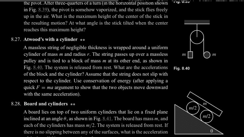

The problem is in attached screenshot. Now,I solved this using force/torque method. However ,I got different solution as given in solution manual. Where I have gone wrong?
Applying F=ma to cylinder:
$$mg-T=ma$$
Applying ##\tau = I\alpha## to cylinder about CoM,
$$TR= I\alpha$$
Since the string doesn't slip we have
$$\alpha= a/R $$
Solving the above 3 with ##I=MR^2/2## we have,
$$Mg= 3Ma/2 \implies a=2g/3$$

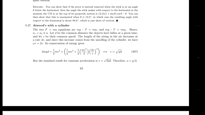

However,the solution is ##a=g/2##. Where I have gone wrong?
  • Textbook diagram of an Atwood machine: a pulley hangs from a ceiling bar, with a block of mass m on the left and a cylinder of mass m on the right, joined by a string over the pulley.
  • Printed textbook page showing solution 8.27, Atwood's with a cylinder, with force equations mg - T = ma and an energy conservation equation 2mgd = ... leading to v = sqrt(gd), and a final line giving a = g/2.
That equation describes the cylinder's motion relative to the string, i.e. where a is the acceleration relative to the string.
Can you describe it in detail?
Please check my reasoning. The velocity of string is due to
1) The block moves down which pulls out string from cylinder
2) The cylinder moves down which unrolls thread
Hence ,total velocity of thread = 2×velocity of cylinder=##\omega ×R## since there is no slipping
Yes.
No. Even if the string were stationary the cylinder would move down unrolling the thread.
