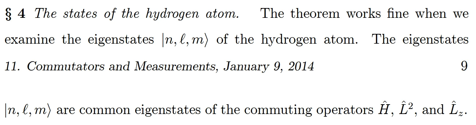

For the free particle the three operators Hamiltonian, ##L^2## and ##L_z## commute togethers. So, it seems that ##\gamma_{3,3}## is also an eigenfunction of the free particle. Could you please explain more?
It is not true that ##\psi## is a free-particle wavefunction just because ##\hat{H},\hat{L}^2,\hat{L}_z## commute when acting on ##\psi##. An obvious counterexample is the hydrogen atom, wherein the electron is bound to a proton:
Printed page from lecture notes, section 4 titled 'The states of the hydrogen atom', stating that eigenstates |n, l, m> are common eigenstates of the commuting operators H, L squared, and Lz.
(https://people.chem.ucsb.edu/metiu/horia/OldFiles/QM2015/Ch11QM.pdf)
It might be helpful if you actually wrote out what ##\gamma_{3,3}## is.
