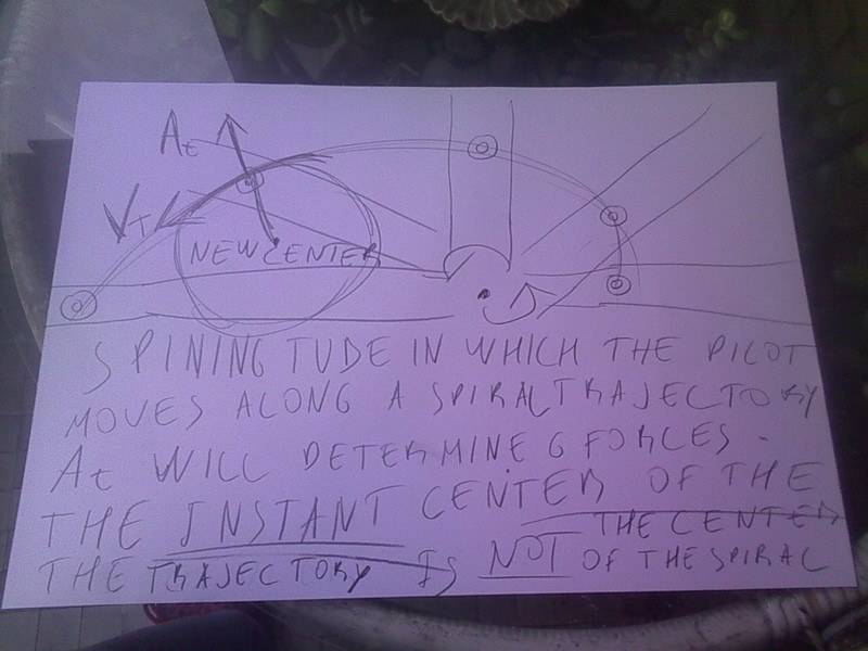

  • A participant proposes a scenario where the pilot moves within a tube that allows for varying radius, leading to a discussion on the implications for normal and tangential acceleration.
  • Concerns are raised about the feasibility of programming the tube's motion to achieve specific conditions for the pilot's trajectory.
  • One participant asserts that if the tube exerts no force on the pilot, he would move in a straight line, challenging the initial assumptions about the pilot's motion.
  • Another participant argues that the proposed motion of the tube may not be possible, suggesting that assuming impossible conditions leads to contradictions.
  • A later reply indicates that the center of curvature of the pilot's trajectory must be considered to accurately calculate normal acceleration and g forces.

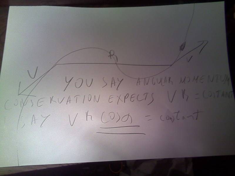

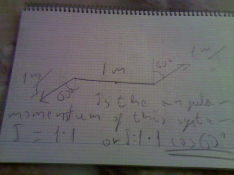

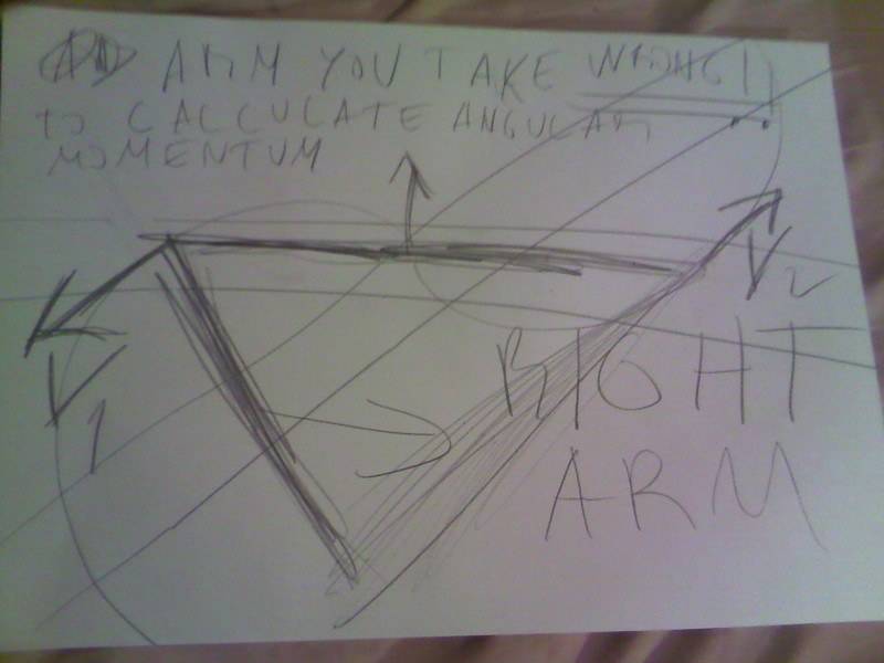

yes but what youre saying its taking the false assumption that when the astronauts leave the tube they do it perpendicular to its mouth while in truth they keep a much more radial vector along the tube
in fact the arm between these two vectors tends to decrease to keep conservation of momentum true as the vectors aim more and more radially
if you take the typical approach to solve the problem first question would be does the astronut accelearte or decelerate?
from conservation of momentum with the pointed false assumption youd expect it to decelerate which can not be

  • #39
No. That is not what I am saying.

  • #60
im not very sure about this:
i know that I= w/arm between the two vectors
so the arm=w/I
also by pithagoras i know cos of the angle of the vector=arm/R and hence arm=cosvectorangle*R so i have:
cos vector angle*R=w/I
but how do i know the trajectory vector angle if initially is 90º from the radial direction and in infinity is 0º from radial direction?
