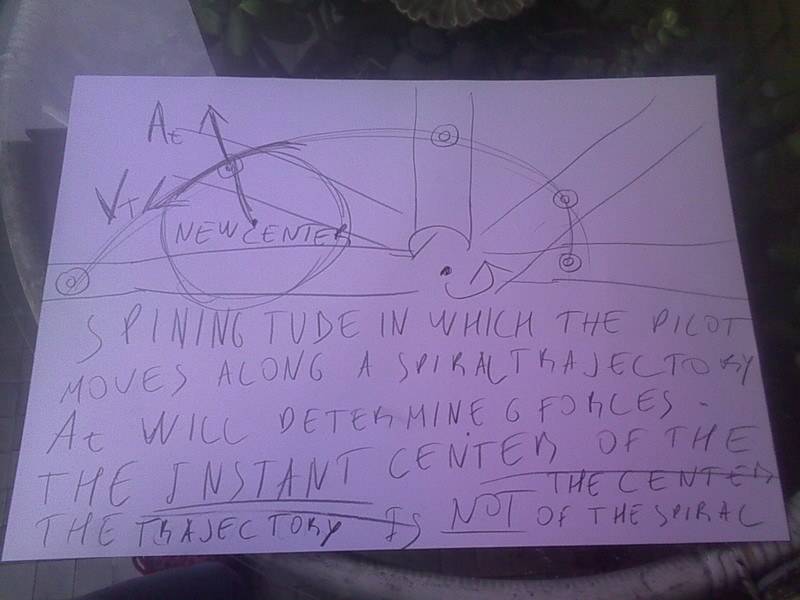

  • #75
well the truth is not democratic
check out my first diagram on tangential and normal vector here:
mage=http%3A%2F%2Fi40.photobucket.com%2Falbums%2Fe222%2Fraaaid%2FIMG_20161207_160421_zpswq8fsjnw.jpg
you just can not take as tangent to the trajectory an arbitrary vector you feel like
  • #76
so check out how v tangential has to follow the path of the trajectory:
of course if you take the v tangential of a circle where there's a spiral you get wrong conclusions
i like to make simple afirmations cause theyre easy to prove wrong unless right
whats wrong of that line affirmation id like to know
  • #77

  • #78
That diagram is perfectly consistent with the meaning of tangential that I am using: "tangential to the path traced out by a point on the tube".

farolero said:
well then you could show to solution of the problen we could be discussing the meaning of words forever
You are the one who is insisting on discussing a particular word meaning to the point that you refuse to understand the analysis.
i can not understand how that a point in the tube that actually makes a circle have any revelance for solving the problem
I already explained that once. I will go over it again more slowly. In addition, you should realize that it is your job to solve the problem, not ours. The Physics Forum way is to guide people to the solutions they seek rather than to simply spit out numbers.
Let us review.
We are trying to find a formula for the angular momentum of the two astronauts plus tube in terms of the mass of each astronaut (m), the angular rotation rate of the tube (##\omega##), the moment of inertia of the tube (I) and the current distance of each astronaut from the center of the tube (R).
I have asked you for such a formula. You have been unable to provide it.
We have reached agreement (I believe) about the angular momentum of the tube alone:
##L_{tube}=I \omega##
We have failed to come to an understanding about the angular momentum of each astronaut. I have a correct formula in mind and have offered a justification for it. You have rejected that justification, apparently out of a disagreement on the meaning of the word "tangential". So it seems that we must avoid the use of that word.
Your current question is how the fact that a point in the tube makes a circle could possibly be relevant to determining the angular momentum of each astronaut.
The astronaut has a velocity. I think you would agree with this.
As viewed from any inertial frame, that velocity is not in a straight line away from the center of the tube. Possibly you will agree with this.
Instead, that velocity is at some unknown angle. Except at the start of the situation, it has a non-zero component in the direction away from the center. We can call this its "radial component". It also has a non-zero component at right angles to that. We can call this its "clockwise component".
At any time while an astronaut is still in the tube, the "clockwise component" of his velocity will match the "clockwise component" of the velocity of the spot on the tube wall that he is passing at that time. This is an assertion with which you may agree after some thought.
We have an easy formula that will give the "clockwise component" of the velocity of a spot on the tube wall.
The "clockwise component" of the astronaut's velocity is important because it is, by definition, perpendicular to the displacement of the astronaut from the axis of rotation.
That means that it is also equal in magnitude to ##v \sin \theta## where theta is the angle that the astronaut's velocity makes with his displacement from the center.
The angular momentum of the astronaut is the vector cross product ##\vec{R} \times \vec{p}## where R is the astronaut's displacement vector and p is his momentum.
Factoring out the m from p=mv, that is also equal to ##m \vec{R} \times \vec{v}##
It is a basic property of vector cross products that this is equal in magnitude to ##mRv \sin \theta## where ##\theta## is the angle that the velocity makes with the displacement vector.
But ##v \sin \theta## is equal in magnitude to the component of the astronaut's velocity at right angles to his displacement.
And that is what we are calling the "clockwise component" of his velocity.
Which is, as above, equal to the "clockwise component" of the velocity of a spot on the wall of the tube at the astronaut's current position.
Which is given by ##\omega R##.
Which is why the circular motion of a point on the tube is relevant.
Edit: ##\sin \theta##, darnit.

ok ill try again.
L=m*w2*R+I*w
anyway i already solved the problem you could tell me what's wrong about it:
youre at artificial gravity free fall for 1 m starting at 1 m/s if you take the centrifugal gravity as linear you get a final speed of 2 m/s if you take it as quadratic less than 2 that you would obtain integrating accounting for all energy in infinity has gone to the astronauts
i think a problem solved simply deserves an extra
also chek out what you say concerning the angular conservation of the astronauts and what i say concerning the angular momentum of the astronauts conservation
theyre very different things and it should be obvious at this stage whose right:)
what do you have to argue to this diagram:)
hence L=mwR2 if false while L=mwR2cosalpha is true
theyre very different things and its up to the people here to see what's the truth and what is not
edit.
if cos alpha is not equal to one and it equals 0.5 for example it can not be L=1 and L=0.5 and be both true at the same time
so either of us is wrong, it can not be we are both right which i seriously pondered
so please you or somebody else tell me what is conserved in the last diagram what you say or what i say

It is amazingly pleasurable to see an equation typeset in TeX and with a definition of the variables sitting there right next to the equation.

im not even sure if those equations are valid for a mid point i would have to see the result and compare it with the result you would obtain with an acceleration of approximately 1 m/s2
anyway i like better thinking on abstract than doing raw calculations where you lose sight of things
as i see it in the beginning there's the vector of the tube and the two vectors of the astronauts with the 0.2 m arm
and finally at infinity the tube vector has disappeared and there are two vectors of the astronauts in opposite sense bigger than initially, the module of the initial vector of the tube has gone to the astronauts
this is what i believe will happen, but being the tube straight and the vectors going along radially and the tube is still at infinity
this is a contradiction for angular momentum would be zero being the vectorial product of the astronauts vectors zero
edit:
the initial angular momentum is 6.6 and the initial energy is 100
i think angular momentum of the astronaut can be neglected:
I=mvR=2*1*0,1=0.2
0.2 can be neglected in front of 6.6 it would make things infinitally easier and see where taking 6.6=mwR2 take us instead of taking 6.6=mwR2sinalpha as i think it should be
maybe you should consider why its wrong to take 6.6=mwR2sinalpha for i don't think you can account for both things at the same time
