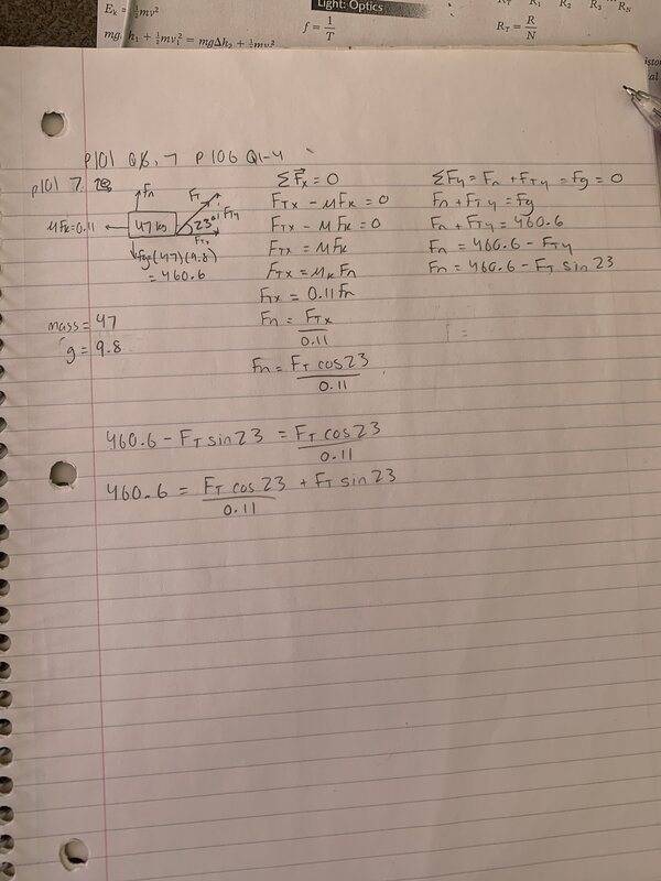

an adult is pulling two small children in a sleigh over level snow. The sleigh and children have a total mass of 47kg. The sleigh rope makes an angle of 23 degrees with the horizontal. The coefficient of kinetic friction between the snow and the sleigh is 0.11. Calculate the magnitude of the tension in the rope needed to keep the sleigh moving at a constant velocity.
Fk=μFn
Fg= mg
ƩFx=0
ƩFy=0
The solution set up looks right.
As a matter of style, it is much better to keep everything symbolic until the end. It has many benefits.
E.g. in the present case write
##F\cos(\theta)=(mg-F\sin(\theta))\mu_k##
##F(\cos(\theta)+\sin(\theta)\mu_k)=mg\mu_k##
etc.
Could you please help me with my next steps?
Look at the right hand side of the last equation. There is FT multiplying both terms. You can write the right hand side as FT(something). What is that (something)?
FT cos + sin ?
This is the sum of two terms. It has to be the product of two terms.
sooo... Ft cos x sin ?
sorry I'm new to the LaTex notation and idk how to put 't' in the subscript like i did before LOL
It's not the LaTeX. It's your algebra skills. Suppose you have 2*3 +2. That's equal to 8. It can also be written as 2*(3+1) which is still 8. Do you see what to do with FT? Incidentally, if you wish to write this in LaTeX you use the underscore, F_T and sandwich the expression between ## on either side. Also, "cos" and "sin" are meaningless without an angle as an argument.
