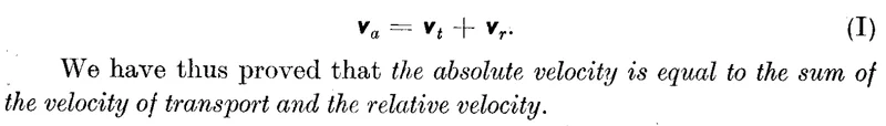

Here are two fragments from Banach's monograph in Mechanics
I have never seen the term <<velocity of transport>> in English texts. Actually I have never seen this term being named somehow in English. This term has a name in Russian books. I looked through the original Banach's text in Polish and there is a Polish name for this term. It is a little bit surprising that the Polish name differs from the Russian one and also differs from this English translation.
My question is: Is there a standard English name for this velocity?
In Russian textbooks ## v_e## denotes the velocity of transport. Nobody knows what the subscript means.
I do not think so. In the text, "(absolute) velocity of the moving frame" is better.
The moving frame can for example rotate and its different points can have different velocities. That is why a correct name of this velocity must refer to the point A.

Isn't the relative velocity equal to zero in this case in which "point A is attached rigidly to the moving frame" respect to which its coordinates do not change?
If that is correct, the velocity of transport should be equal to the absolute velocity of point A in the descibed scenario.

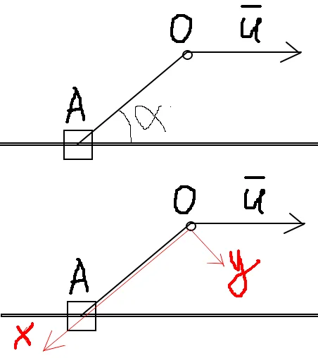

Consider an example. Let a slider ##A## move along a horizontal beam. There is an inextensible string attached to the slider. The string is threaded through the ring ##O## and the end of the string is pulled with constant velocity ##\boldsymbol u,\quad |\boldsymbol u|=u##. Find a velocity of the slider as a function of the angle ##\alpha##.
Solution. Introduce a frame ##Oxy##. This frame rotates about the point ##O##. Thus a velocity of transport of the point ##A## is
##\boldsymbol v_t=w \boldsymbol e_y.##
The velocity of ##A## relative ##Oxy## is
##\boldsymbol v_r=-u\boldsymbol e_x.##
The velocity of ##A## relative the lab frame is
##\boldsymbol v=-v\cos\alpha \boldsymbol e_x+v\sin\alpha \boldsymbol e_y.##
Equation (I) gives
$$v=\frac{u}{\cos\alpha}.$$
