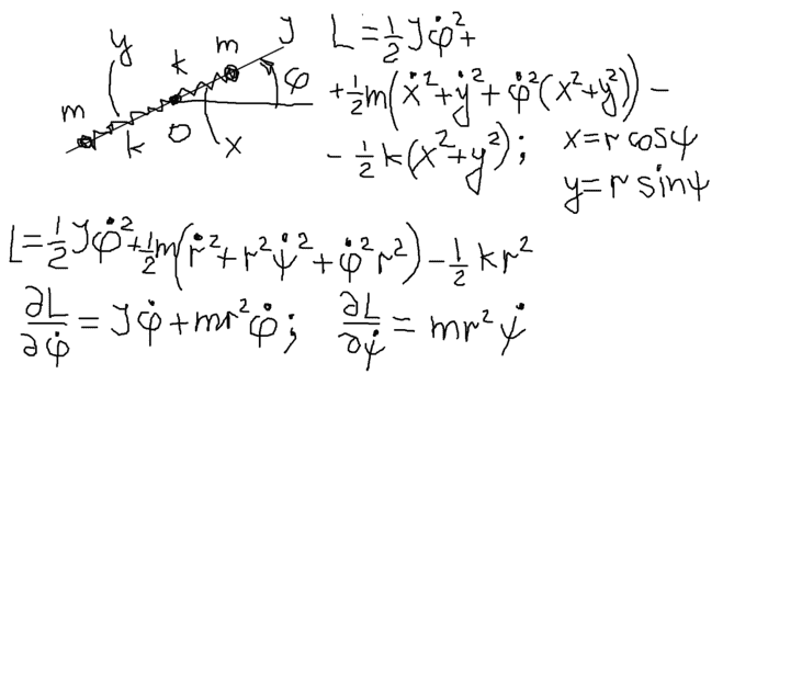

The following problem we considered with the students. Perhaps it would also be interesting for PF
A homogeneous rod can rotate freely in a plane about its (fixed) center of mass O . The corresponding moment of inertia is equal to J. Two identical particles of mass m can slide along the rod freely. Each particle is connected with the point O by a spring of stiffness k. The relaxed length of both springs is equal to zero.
This system has 3 degrees of freedom: the angle of rod's rotation ##\varphi## and the distances ##x,y## from the particles to the origin O. Two integrals are obvious: the energy and the angular momentum. But there is a third less banal integral: see the attachment.
This observation allows to reduce the system to one degree of freedom and then study it by means of the effective potential.

If I see it right, the coordinates ##\psi## and ##\varphi## are cyclic. Then ##L## is not explicitly time dependent, so that ##H## (energy) is conserved either. So you've three first integrals and an integrable system, right?

I'll start by tidying it up a bit. The Lagrangian is
$$L ~:=~ \frac12 J \dot\phi^2 ~+~ \frac12 m \left(\dot r^2 + r^2 \dot\psi^2 + r^2 \dot\phi^2\right) ~-~ \frac12 k r^2 ~.$$ I compute the canonical momenta to be $$p_r =
m \dot r ~,~~~~ p_\phi = (J + m r^2) \dot\phi ~,~~~~ p_\psi = m r^2 \dot\psi ~.$$ and I compute the Hamiltonian as $$H ~=~
\frac{p_r^2}{2m} ~+~ \frac{p_\phi^2}{2(J+mr^2)}
~+~ \frac{p_\psi^2}{2mr^2}
~+~ \frac12 k r^2 ~.$$ From the Hamiltonian form of the EoM one quickly finds that ##p_\phi## and ##p_\psi## are constants.
I compute the Lagrangian (E-L) equations of motion to be $$
\ddot r ~=~ r(\dot\phi^2 + \dot\psi^2) + \frac{kr}{m} ~~=:~ w_r ~,$$$$
\ddot\phi ~=~ -\, \frac{2mr \dot r \dot\phi}{J+mr^2} ~~=:~ w_\phi ~,$$$$
\ddot\psi ~=~ -\, \frac{2\dot r \dot\psi}{r} ~~=:~ w_\psi ~.$$To find nontrivial first integrals (a.k.a constants of the motion) systematically we need the canonical on-shell total time derivative operator: $$A ~:=~
\frac{\partial}{\partial t} ~+~ \dot q^a \frac{\partial}{\partial q^a}
~+~ w^a \frac{\partial}{\partial \dot q^a} ~,$$where the ##q_a## are ##r,\phi,\psi##, etc. First integrals are functions ##f(t,r,\phi,\psi,\dot r, \dot\phi, \dot\psi)## of the phase space variables satisfying $$A \, f ~=~ 0 ~.$$[I'll continue tomorrow. Have I made any mistakes so far?]

That looks good, but why are you looking for more "first integrals". You already have 3 independent ones, i.e., ##p_{\phi}##, ##p_{\psi}##, and ##H##. From this you can find an effective 1D equation of motion for ##r##.
