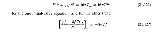

The problem is MTW Exercise 21.10 (attached)
The relevant equation is the Initial Value equation 21.127 (attached)
Can anyone help me get started with this problem?
What should I use for Gni?
I've tried to produce Tni by working out Rni (using methods developed in an earlier chapter) but the results don't lead me anywhere.
I'm really stuck for a way forward on this problem so if anyone can help, it would be much appreciated.TerryW

Typeset equations (21.126) and (21.127) from a general relativity text: 3R + γ2/N2 = 16πTnn = 16πTnn, and [γi^h − δi^k Tr γ / N]_jk = −8πTi^n.

I started off by assuming that the first line of the question is telling me that ##K_{ij}= 0##. In which case,
(21.127) reduces to ##8\pi T_i{}^n =0##.
If ##T^{nn} = \rho## (which seems to be the implication of (21.132)) and ##T_i{}^n =g_{in}T^{nn}##
then I end up with ## g_{in} \rho = 0## or ##N_i\rho =0 ## if ##g_{in} = N_i## which doesn't help me very much.
I am clearly not seeing something here!Regards
TerryW
I think that (1) tells you that ##K_{ij}=0##, yes. But before that it says "empty space", which tells you that the stress-energy tensor is zero. So I think you are being asked to solve the left hand side of 21.127 equals zero. That presumably nets you an expression for ##\psi##.
The left hand side of 21.127 is ##\frac{\gamma _i{}^k - \delta _i{}^k Tr\gamma}{N}##
If ##\gamma _{ij} = \frac {1}{2}(N_{i|j} +N_{j|i} - \frac{∂g_{ij}}{∂t}) = NK_{ij} ## and ##K_{ij} = 0##
then surely the LHS = 0 doesn't it?TerryW

Ok. But notice that equation 21.67 is also a differential equation, and saying that the LHS of 21.127 is zero (either because the RHS, the stress-energy tensor, is zero, or because ##K_{ij}## is zero) is just saying that the differential equation is homogeneous. In other words, you still have to solve the differential equation.
Ok, I've processed the differentiation as follows (in detail):
##\big( \frac{\gamma_i{}^k - \delta _i{}^k Tr \gamma}{N}\big)_{|k} = 0##
##-\frac{N_{|k}}{N^2}(\gamma_i{}^k - \delta _i{}^k Tr \gamma) +-\frac{1}{N}(\gamma_i{}^k - \delta _i{}^k Tr\gamma)_{|k} = 0##
The first term disappears because ##\gamma_{ij} = 0## leaving me to process:
##(\gamma_i{}^k - \delta _i{}^k Tr\gamma)_{|k} = 0##
##(g^{jk}\gamma_{ij|k} - \delta _i{}^k g^{lm} \gamma_{lm|k} = 0##
##g^{jk}(\gamma_{ij,k} -\Gamma^l{}_{ik}\gamma _{jl}-\Gamma^l{}_{jk}\gamma _{il}) - \delta _i{}^k g^{lm} (\gamma_{lm,k}-\Gamma^p{}_{lk}\gamma _{mp}-\Gamma^p{}_{mk}\gamma_{lp}) = 0##
All the terms with ##\Gamma## disappear because ##\gamma_{ij} = 0## leaving me with:
##g^{jk}\gamma_{ij,k} - g^{lm} \gamma_{lm,i} = 0##
Given that ##\gamma_{ij} = 0## everywhere on the hypersurface, then ##\gamma_{ij,k} = 0## everywhere too, leaving me with the unarguable 0 - 0 = 0, but nowhere near the answer!RegardsTerryW

A suggestion: the problem gives you the 3-metric. Try simply turning the crank: write down the lapse and shift functions and their derivatives, and the time derivative of the metric, which gives you an explicit formula for ##\gamma_{ij}##, then simply plug into equation 21.127 and see what you get.
The discussion at the start of section 21.10 might also be helpful. (Note that that discussion seems to indicate that you might also want to look at equation 21.126, of which equation 21.132 is a simplified form.)

I also cannot see what I could possibly get out of 21.126
21.126 for this case says that ##R = 0##, i.e, the Ricci curvature scalar for the 3-metric on the given hypersurface is zero. That gives you a differential equation for ##\psi##.

21.126 for this case says that R=0, i.e, the Ricci curvature scalar for the 3-metric on the given hypersurface is zero. That gives you a differential equation for ψ.
I think I'll go with this idea for the moment. (Using 21.137 looks more complicated!) - I can see that quite a bit of work is going to be required and I won't be around for the next few days, so it will be a while before I let you know how I've got on.
In the meantime, thanks for all the help.RegardsTerryW
In equation (21.137), ##R_1 = 0## for exercise 21.20. So, you're left with solving ##\mathbf \nabla_1^2 \psi = 0##.
Equation (21.137): the Laplacian operator on subscript 1 applied to psi, minus (R sub 1 divided by 8) times psi, equals zero.
Use (21.136) where ##g_1## and ##g^{ik}## refer to the metric ##d \overline r^2 +\overline r^2 d\theta^2 + \overline r^2 \sin^2 \theta \, d \phi^2##.
Equation 21.136: the Laplacian of psi on a curved space, written as nabla_1 squared psi = psi_{|i}^{|i} = g_1^{-1/2} (partial/partial x^i) [g_1^{1/2} g^{ik} (partial psi / partial x^k)].

FollowingTSny's suggestion of using 21.137 and 21.136, I've produced the required result, so thanks for that!
I'm still going to try to get the result by working out R in terms of derivatives of ##\psi## just for the satisfaction of seeing it all come out.
One question arising from all this - In obtaining the result, I ended up with an expression with a ratio of arbitrary constants. I can quite legitimately resolve these into ##\frac {m}{2}##, but what is ##m##?
Given that the problem statement defined an empty space, how can ##m## be a mass and if it isn't a mass, what exactly is it?
