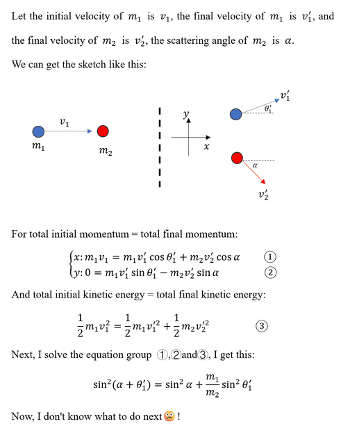

For an elastic collision between a projectile particle of mass m1 and a target particle (at rest) of mass m2, show that the scattering angle, θ’, of the projectile (a) can take any value, 0 to 180°, for m1< m2, but (b) has a maximum angle φ given by cos²φ=1-(m2/m1)² for m1> m2.
total initial momentum = total final momentum
total initial kinetic energy = total final kinetic energy
The equation you derived is probably not very useful. One idea is to use the law of cosines for the momentum vectors. You can draw a triangle with the initial momentum (##m_1v_1##) along the base, and the momentum of the two particles after the collision as the other two sides. You can do this two ways, giving you an expression involving either ##\cos \alpha## or ##\cos \theta'_1##.
PS although there is nothing wrong with your notation, simply ##\theta## would have done just as well as ##\theta'_1##.
PPS I looked up my notes and I don't have a ready solution for this exact problem. But, I think you need to do more than manipulate equations. For part b) you might think about the problem in the centre-of-momentum (zero-momentum) frame, in order to establish an important point about the angle ##\theta##.
In fact, a completely different approach would be to use the centre-of-momentum frame to establish the range of angles for ##\theta##, then to transform back to the frame in which ##m_2## is at rest.

If you expand the LHS of your last equation some useful cancellations can be made.
I didn’t follow through to completion but it looks promising.

Minming said:
Your issue lies in not fully understanding the reasoning behind your approach. Why did you solve those three equations for the two angles? The goal is to analyze the angle ##\theta '_1##, so you need to use those three equations to eliminate the variables ##\alpha## and ##v'_{2}##. By doing this, you will derive an equation that can be directly used to answer both part (a) and part (b) of the problem easily.
That may work algebraically, but it does not finish the job in terms of logic.
In setting up the collision, the variable you can control is ##\alpha##, not ##v'_1##. If you find that a value of ##\theta'_1## can be achieved by a certain value of ##v'_1/v##, how do you know that value of ##v'_1/v## can be achieved?

It's a shame that the OP hasn't replied, as it would be good to compare the various approaches. I used the law of cosines and implicit differentiation.

Thanks. I'll study centre-of-momentum frame, and try to solve it.
Hi, the law of cosines and implicit differentiation is useful, I get the answer by dθ'/dα =0, and get sinθ'=m
2/m1, it's same to the answer(when m1> m2). thanks
