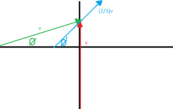

Is this an accurate representation of what is going on? (my terrible drawing skills aside) the green and red vectors are the two particles before the collision and the blue one with angle θ' is the two of them moving while stuck together.

I am ending up with an equation for the x components:
vcosθ = (4/3)vcosθ'
and for the y components:
vsin + v = (4/3)vsinθ'
for simplicities sake I said, that you can make one of the particles move parallel to the x axis, then this eliminates one of the unknown angles.
Wouldnt that have to assume that the angle between the two starting vectors is 90 degrees?
No it wouldn't, imagine rotating the x and y-axis so that the one particle is moving parallel to the x axis. Instead of two angles, its one.

I think it would be simpler to take the final motion as being along an axis. Given that they have the same mass and initial speed it follows that they made the same angle to the axis on approach,
