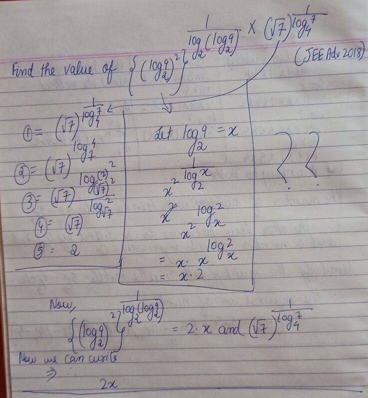

$$\{ (log_2 9)^2 \}^{\frac {1} {log_2(log_2 9)} } \cdot (\sqrt 7)^\frac {1} {log_4 7}$$
$$ x^{log_a x}=a $$
This is my work. I don't know whether this is correct or not. What do you think of the problem.
Thanks!
  • Handwritten solution on lined paper to a JEE Advanced 2018 problem: finding the value of ((log9 2)^2) raised to 1/log2(log9 2) times (sqrt7) raised to 1/log4 7, with substitution log9 2 = x and steps ending in 2x.

It works much better if you type your work into the forum using LaTeX. It is much easier for us to read and to quote any parts that we want to clarify/correct.
Please look at the LaTeX Guide in the lower left of the Edit window. Thank you.

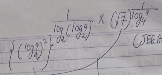

A snip of your posted image gives the expression you are trying to simplify as:
Handwritten expression: {(log_2 9)^2} raised to the power 1/(log_2(log_2 9)) times (sqrt 7) raised to the power 1/log_4 7, with a bracket indicating the exponent grouping, partly cut off on the right.
By The Way: The ##{LaTeX}## code for ##\log_2 9## is ##\log_2 9## .
From your posted image, it appears that entire expression, ##\dfrac {1} {\log_2(\log_2 9)} \cdot
(\sqrt 7)^\left ( \dfrac {1} {\log_4 7} \right)## is to be used as the exponent for ##(\log_2 9)^2 ## .
You did correctly find that ## (\sqrt 7)^\left ( \dfrac {1} {\log_4 7} \right) = 2## .
But there are mistakes elsewhere.
I see two mistakes right now.
1. You left out the factor of 2 you derived in your step number 5
2. You forgot to set one bracket:
Your step from $$x^{2^{log_x(2)}}$$ to $$x\cdot x^{log_x(2)}$$ is wrong. There need to be brackets around both x: $$(x\cdot x)^{log_x(2)}$$ Therefore the exponent needs to be applied to both x $$x^{log_x(2)} \cdot x^{log_x(2)}$$
I think with these informations you should be able to find the correct answere. But feel free to ask additional questions.

SammyS said:
You did correctly find that ## (\sqrt 7)^\left ( \dfrac {1} {\log_4 7} \right) ## ##= 2## .
I don't think I've even seen ##\large{\log_{A^F} C^F= \log_{A} C }## stated as a rule for logarithms, but it does work.
(In reference to you changing ##\large{\log_{(\sqrt{7})^2} 2^2}## to ## \log_{(\sqrt{7})} 2 ## .)
