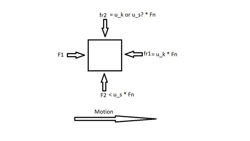

The discussion centers on the behavior of friction coefficients when a body moves in a specific direction on a surface, such as a table defined by an x-y Cartesian plane. When a force less than the product of the static friction coefficient (μs) and the normal force (Fn) is applied in the y direction while the body moves in the x direction, the friction acting in the negative y direction is classified as kinetic friction. The conversation highlights that even when movement occurs in one direction, the frictional forces are consistent across all directions due to the interaction of surface irregularities.

If a body is moving in one constant direction, is it considered stationary with respect to other directions? For example, consider a table. Let the surface of the table be defined by an x-y Cartesian plane. If the body is moving in the x direction on the table, and a force (< (μs * Fn)) is imposed in the positive y direction, does the friction acting in the negative y direction act through kinetic or static friction?
