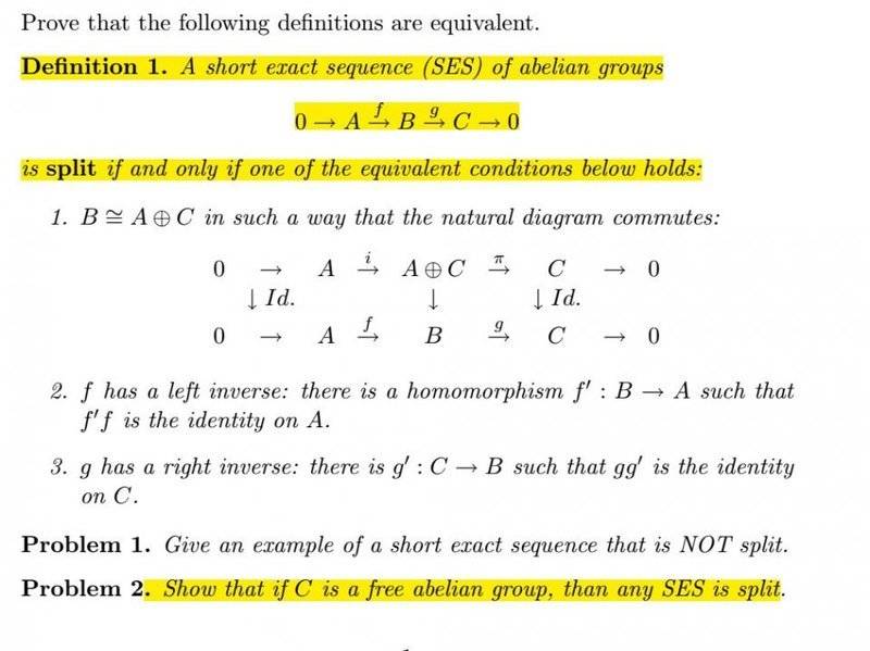

I am looking at a statement that, for a short exact sequence of Abelian groups
##0 \to A\mathop \to \limits^f B\mathop \to \limits^g C \to 0##
if ##C## is a free abelian group then this short exact sequence is split
I cannot figured out why, can anybody help?
So can you start by telling us what your definitions are of a split sequence and of a free Abelian group?
Are there any theorems already, e.g. about projective modules?

Please see the attached picture in the post above. Since I know nothing about modules, can we restrict our case to groups?
the splitting would follow if the map g has a right inverse whiuch is a group homomorphism. free abelian groups are, almost by definition, those abelian groups on which it is very easy to define homomorphisms.
And how is a free Abelian group defined? Is there a mapping property you can use to construct a commutative diagram for
$$ \begin{matrix} &&C&& \\ & & \downarrow & & \\ B & \longrightarrow & C & \longrightarrow & 0 \end{matrix} $$

Now ##g## is surjective and for each ##1_{\iota}## in this component of ##C## there is a pre-image ##b_\iota \in B##, i.e. ##g(b_\iota)= id_C (1_\iota)##. Now how could you define your ##g' \, : \, C \rightarrow B## with ##gg'(c_\iota)=\underbrace{1_\iota + \ldots + 1_\iota}_{c_\iota \text{ times }}\;##?

Say ##C## is a free abelien group built on a basis ##\{ {a_i}\} ## . Since ##g## is surjective, for each ##{a_i}## there is a ##{b_i} \in B## such that ##g({b_i}) = {a_i}##. It is also true that ##g({n_i}{b_i}) = {n_i}{a_i}##. This correspondence on the other hand defines an isomorphism (is this right?) between ##\{ {n_i}{b_i}\} ## and ##\{ {n_i}{a_i}\} ##. So we find a ##g':C \to B## such that ##gg' = i{d_C}##.

Well, I've already almost written the proof. Whether you call the generators ##a_i## or like me ##1_\iota## doesn't make a difference. Considering your proof, I cannot see this isomorphism. What happens in a situation like
$$ 0 \longrightarrow \mathbb{Z} \longrightarrow \mathbb{Z} \oplus \mathbb{Z} \longrightarrow \mathbb{Z} \longrightarrow 0$$
and how exactly do you define ##g'(c)\;##?

What about what I've written in post #13? Simply define ##g'(c_\iota) := b_\iota## where the ##c_\iota## are generators of ##C## with pre-images ##b_\iota \in B## under ##g##. I only took ##\iota## as index instead of ##i## because usually ##i## denotes something countable and ##\iota## any index set ##I\,##. And we don't know anything about ##I\,##. You don't have to bother, whether ##B## is isomorphic to ##C## or not. All we can say for sure is, that ##g## is surjective and ##C## is freely generated over ##\{c_\iota \,\vert \, \iota \in I\}\,##, i.e. an arbitrary ##c \in C## looks like ##c= \Sigma_{\iota \in I} \,n_\iota \cdot c_\iota##. With that you can calculate ##gg'(c)\,##.

What about ##\{0\} \longrightarrow \mathbb{Z}_2 \longrightarrow \mathbb{Z}_2 \oplus \mathbb{Z} \longrightarrow \mathbb{Z} \longrightarrow \{0\}\; ##?
You still need to actually define ##g'\, : \, C \longrightarrow B## with ##gg' = id_C\;##. What you don't need is an isomorphism with ##B## (see my example) and homomorphy isn't the problem. If you define all ##g'(c_\iota)## you can extend it to an homomorphism. There is no need to introduce a set ##B'## or to consider the group it generates, only the elements ##b_\iota## with ##g(b_\iota) = c_\iota \,## are needed. Of course there is still the equivalence of the three properties in your definition (or theorem?) of a split exact sequence. (Just as a remark: In my book it says "direct exact sequence", which is somehow telling. However, "split" is the usual term.)

This is essentially correct. You still need to write down the splitting homomorphism from ##C## into ##B## and to show that it is actually a homomorphism.
To illustrate why, consider a couple examples.
For the sequence ##0→Z_4→Z_8→Z_2→0##, a generator ##c## of ##Z_2## has a lift ##b## to ##Z_8## so ##gg'(c) = c## but the map ##0→0## ##c→b## is not a homomorphism.
If ##C = Z⊕Z## and ##B## is the free group on two generators, one has an exact sequence
##1 →A →F(b_1,b_2) →Z⊕Z→0## where ##A## is the commutator subgroup of ##F(b_1,b_2)##. The set ##b_1## and ##b_2## and ##1## are your set ##B'## but the map ##c_1→b_1## ##c_2→b_2## ##0→1## does not determine a homomorphism.
Another example, similar to the free group example, is perhaps a little more clear. Let ##B## be a group with 3 generators ##a## ##b_1## and ##b_2## each of which generates a free abelian group and with the relations ##[b_1,b_2] = a## and ##[a,b_{i}] = 1## where ##[,]## denotes the commutator.
##B## is not abelian and it fits the exact sequence, ##0→ Z →B→Z⊕Z→0## This sequence is not split.
- It might be helpful to consider whether or not every sequence ##1→A→B→Z→0## is split whether or not ##B## is abelian.

Thanks very much, I got the point.
