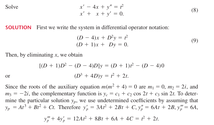

shemer77 said:
http://gyazo.com/6c440aa92106f729639c91f6d59dcd89
My question is why is yp = At^3+Bt^2 +Ct. The reason I ask that is because is see t^2+2t so why wouldn't it be yp=At^2 +Bt +c?
Textbook solution showing a system of differential equations in operator form, elimination of x leading to (D^3 + 4D)y = t^2 + 2t, and the undetermined coefficients setup y_p = At^3 + Bt^2 + Ct with its derivatives.
Because (D3 + 4D)( At3+Bt2 +Ct) = 12At2 + 8Bt + 6A + 4C .
Whereas, (D3 + 4D)( At2+Bt+C) = 8At + 4B, which is not a quadratic.
