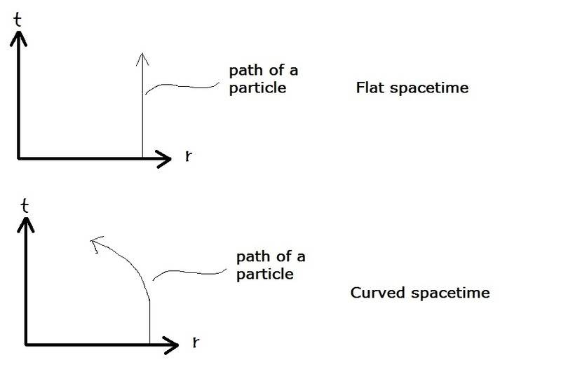

Well, if you think you understand how curved space could cause a moving particle to move along a curved spatial path, then it's conceptually not much different to understand how curved spaceTIME could cause a particle to move along a curved spacetime path. In the top figure below is a representation of spacetime as a two-dimensional manifold, with coordinates labeled [itex]t[/itex] for time and [itex]r[/itex] for space (distance from the center of the Earth, for example). In flat spacetime, which means spacetime without gravity, a particle initially at rest will stay at the same location in space, which means that [itex]r[/itex] doesn't change. But the particle continues to move forward in time. So the path of the particle is vertical when shown on a [itex]t-r[/itex] graph.
If instead spacetime is curved, then the path of the particle will not be straight as shown on a [itex]t-r[/itex] graph.

It depends. When you want to show orbits you need at least 2 spatial dimensions, which together with time would require showing a curved 3D manifold. That is difficult to visualize in a single diagram, so you can only show certain aspects with curved 2D sheets. The common indented 2D sheet visualization shows only the spatial effect, which is not really what causes the planets to orbit, but merely what causes their orbits to precess. So yes that is misleading.
But for vertical (radial) fall you only need 1 spatial dimension, so it it perfectly OK to reduce 4D spacetime to 2D spacetime (time + 1D-space). See the videos in post #4.

As A.T. points out, for a rock falling straight down, only one spatial dimension is relevant--the direction that the rock is falling. So 2D (one dimension for the only relevant spatial direction, and one dimension for time) is perfectly adequate to describe what's happening to the rock.

DrGreg said:
This is my own non-animated way of looking at it:
  • A Two inertial particles, at rest relative to each other, in flat spacetime (i.e. no gravity), shown with inertial coordinates. Drawn as a red distance-time graph on a flat piece of paper with blue gridlines.
  • B1. The same particles in the same flat spacetime, but shown with non-inertial coordinates. Drawn as the same distance-time graph on an identical flat piece of paper except it has different gridlines.
    B2. Take the flat piece of paper depicted in B1, cut out the grid with some scissors, and wrap it round a cone. Nothing within the intrinsic geometry of the paper has changed by doing this, so B2 shows exactly the same thing as B1, just presented in a different way, showing how the red lines could be perceived as looking "curved" against a "straight" grid.
  • C Two free-falling particles, initially at rest relative to each other, in curved spacetime (i.e. with gravity), shown with non-inertial coordinates. This cannot be drawn to scale on a flat piece of paper; you have to draw it on a curved surface instead. Note how C looks rather similar to B2. This is the equivalence principle in action: if you zoomed in very close to B2 and C, you wouldn't notice any difference between them.
Note the diagrams above aren't entirely accurate because they are drawn with a locally-Euclidean geometry, when really they ought to be drawn with a locally-Lorentzian geometry. I've drawn it this way as an analogy to help visualise the concepts.
