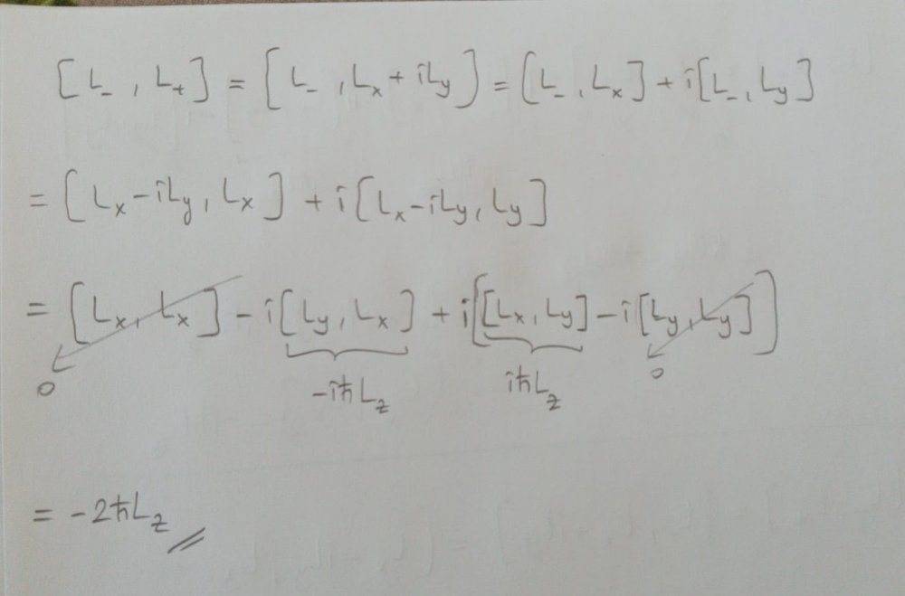

is my solution correct?

Not the way you write it. $$[L_x,L_y]=-i\hbar L_z$$
[edit] Sorry for confusing you. I made (a single) a sign error too !
The intention was to write $$[L_x,L_y]=\ \ \ i\hbar L_z\\ \ [L_y,L_x]=-i\hbar L_z$$
Two wrongs doesn't make a right
Wan Anavan said:
Homework Statement:: Analysis of Angular Momentum
Relevant Equations:: Commutators
You are not being careful enough. You must write out more steps as you're going wrong with the shortcuts.
No. Write out ##L_+## and ##L_-## and explicitly multiply

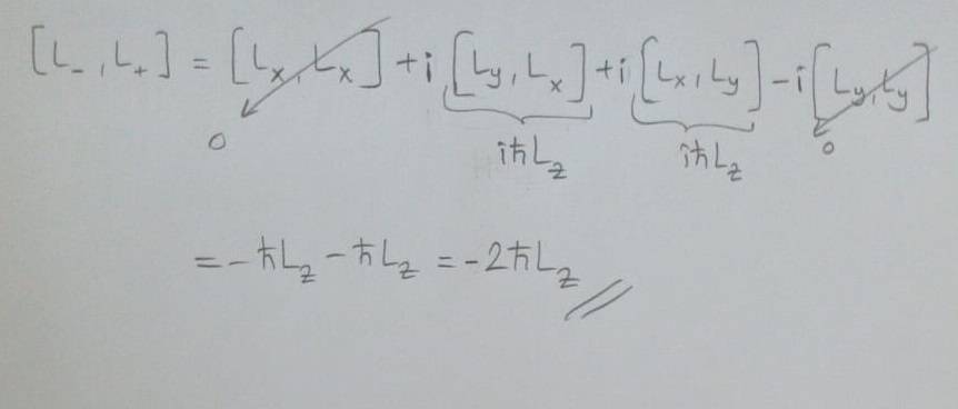

then the answer is not zero
This time answer and solution are correct.
You can check yourself by working out ##\Bigl [L_+,L_-\Bigr ]## :wink:
