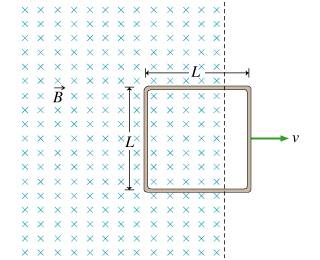

A loop of wire is at the edge of a region of space containing a uniform magnetic field B. The plane of the loop is perpendicular to the magnetic field. Now the loop is pulled out of this region in such a way that the area A of the coil inside the magnetic field region is decreasing at the constant rate . That is, [tex]\frac{dA}{dt} = -c[/tex] , with c >0 .
The induced emf in the loop is measured to be V. What is the magnitude B of the magnetic field that the loop was in?
Express your answer in terms of some or all of the variables A ,c , and V.

So I know [tex]B = \frac{\Phi_m}{A}[/tex], would I just find the derivative of that?
ok well you know [itex]\Phi=BA[/itex]
and Faraday's law is that the emf induced.[itex]E=-\frac{-d\Phi}{dt}[/itex]
so
[tex]E= - \frac{d\Phi}{dt} = - \frac{d}{dt}(BA)[/tex]
B is constant so you can can remove it from inside the brackets...Can you see it better now?
So it's like this:
[tex]\Phi = BA[/tex]
[tex]- \frac{d\Phi }{dt} =-B \frac{dA}{dt}[/tex]
[tex]E = -B(-c) = Bc[/tex]
which implies that B = E/c (assuming I didnt make any mistakes), but it says I need to express it in terms of A, c, or V.
Did I make a mistake anywhere?
Well E is really V..so V=Bc.
So for the second part of the question, I have to find the value of c and terms of v and L
[tex]c = \frac{V}{B} = \frac{vLB}{B} = vL[/tex]
I didnt make any stupid mistakes, did I?
Or you could have done it in a different way and say that in 1s the coil moves vm so that the area swept out in 1s is vLm^2. meaning that dA/dt=-c=vL.
