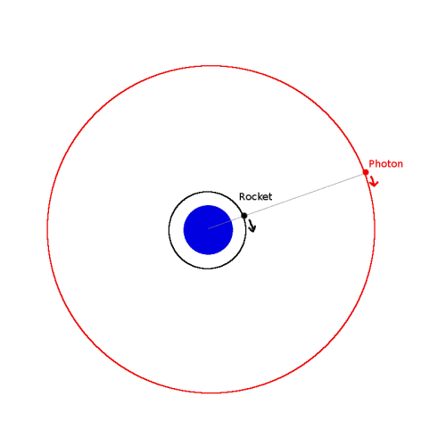

Let's imagine a rocket orbiting the earth. The rocket could be any real rocket with moderate speed, so that relativistic effects are not significant, and also rocket does not experice notable centrifugal or other acceleration (so the rockets reference frame would appear almost inertial).
A photon orbits Earth with long enough radius so that its angular velocity matches the rockets angular velocity (see image if necessary). At any time, from rockets reference frame the photon is at constant distance directly on the side. Should we conclude that the photon is stationary when looked from rocket's frame? If yes, how the photon can exist in rocket's frame at all, having no speed (no kinetic energy) or rest mass? If no, i.e. the photon is not stationary but moves, how it actually moves relative to rocket?
I know the rocket is not strictly an inertial observer, but it's "almost" so. And in any case, the rocket is an observer (inertial or not) and the existence of a photon doesn't sound like a frame-dependent thing. I'm sure that there is a solution to this, but nothing that I can see right now. Thanks.

It is not almost inertial. As you have described it the rocket is rotating. It can measure it's rotation locally using gyroscopes or ring interferometers. The second postulate does not apply to the rockets frame and the rocket knows it.
It's also worth noting that there is no photon orbit for the earth. The photon orbit for a mass of the Earth would require that the mass be concentrated in a diameter less than 3 cm, and the photon would orbit at a radius of about 1.5 cm.
You can imagine the photon being guided by some type of wave guide (e.g. a mirrored tube at a large enough radius to get what you want). But then, as Dalespam has already noted, the scenario is not different than asking 'where does the huge kinetic energy of distant mountains come from when I turn my head rapidly?'. In a rotating frame, inertial motion can look highly accelerated and light can travel at any speed you want.

First, note that 'existing for the rocket' (meaning the rocket could, for example, send out a probe that detects the photon and later get the information back), has nothing to do with the choice of frame or coordinates by the rocket. An astronaut on the rocket could use any frame they want, and we don't normally try to describe solar system motions in coordinates centered on (say) Zurich. Even though Zurich coordinates are effectively inertial for many local observations, they are wildly non-inertial on the scale of the solar system. It is also unremarkable that some coordinates have limited range of utility. For example, Rindler coordinates don't cover any part of spacetime outside of a wedge bounded by the Rindler horizon.
Similarly, any rotating frame has limited useful coverage. This says nothing about existence, only about problems with a particular coordinate choice. In particular, at the photon radius in your rotatiing coordinates, a line of constant coordinate position is no longer timelike - it has become 'light like' or null directed. Energy can only be defined in reference to a timelike basis. Thus energy cannot be defined relative to a vector of constant position at this radius, in these coordinates. This is not really remarkable. Physically, it is saying that you can't define the energy of a photon relative to another photon. It can only be defined relative to a material particle (which follows a timelike trajectory, defining a timelike direction for energy measurement).

The "local inertial frame" approximation requires not only a short period of time but also a small distance. The distance to get a stationary photon is, essentially by definition, not small. There is simply no avoiding it, the rocket's frame is non-inertial.

The particle will be moving in these coordinates. It can't be stationary, or it wouldn't be following a timelike world line. Energy is measured by such a particle, and the amount measured depends on the relation between the particles 4-momentum and the photon's 4-momentum (which is perfectly well defined in such coordinates; it is just no longer (E,p) in these coordinates.). In the terms I explained in my last post, the particle's world line defines a timelike tangent vector. The dot product of the photon 4-momentum with this is the energy the particle will measure for the photon. Particles with different motion would measure different energy for the photon. None could measure zero because none can be stationary in these coordinates (at the photon radius).
[Note, in relation to Nugatory's points: I am, for the sake of discussion, willing to use the 'geometric optics' classical picture of a photon as following a null path, and having a 4-momentum. This is not accurate, but is an adequate idealization for some purposes.]

(b) is mostly accurate. A key point is that a photon does not have energy as an intrinsic property (in the way rest mass is intrinsic to massive particle). Instead, in all cases, a photon's energy is only defined in reference to a particle it interacts with. Given two identically prepared photons moving in parallel, if two particles with with relative speed between them interact with the two photons, they will measure different energy. This is all normal, and coordinate independent (that is, this would be true, in Minkowski coordinates). So, a more precise statement is: even though a photon is stationary in these coordinates, it still has a defined energy in relation to any particle that might interact with it.
