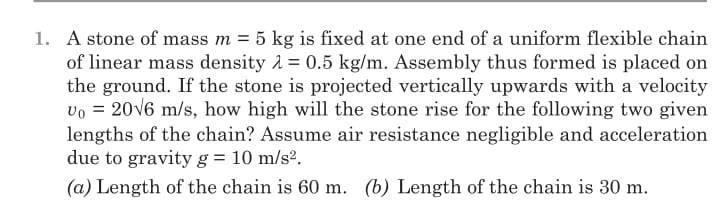

Typed physics problem: a stone of mass m = 5 kg fixed to one end of a uniform flexible chain of linear mass density λ = 0.5 kg/m, projected vertically upward at v0 = 20√6 m/s; asks height for chain lengths 60 m and 30 m, parts (a) and (b).
In order to be able to solve the problem, I think I must find the equation of ##h## with respect to ##\dot h##.
Assuming that ##F## is the action-reaction force between the stone and the end of chain, then the Newton's equation
For the stone:$$-F-mg=m \ddot h$$ $$-\int (F+mg)dh = \frac 1 2 m(\dot h^2 - Vo^2)...(1)$$

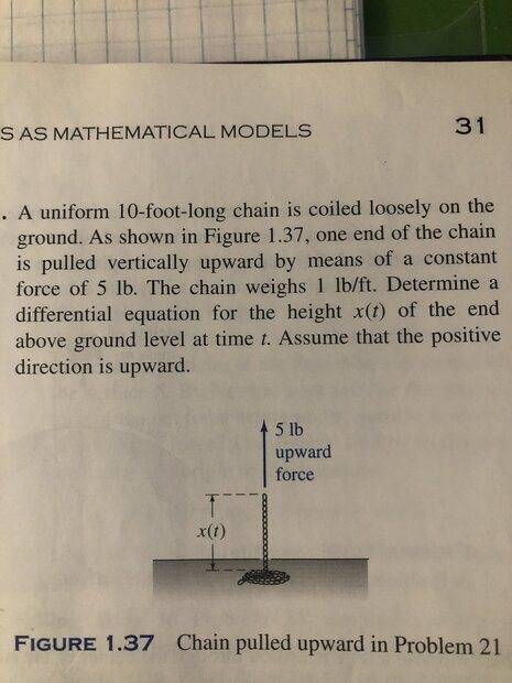

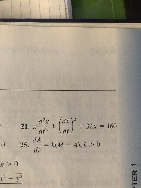

Anyhow, here is a similar problem, and it was answered in the back of the book.
Textbook figure 1.37 showing a chain coiled on the ground, one end pulled vertically upward by a 5 lb upward force, with height x(t) marked above ground level.
Printed textbook page showing differential equations: problem 21, x times d2x/dt2 plus (dx/dt) squared plus 32x equals 160; problem 25, dA/dt equals k(M minus A), with k greater than 0.

But I'm looking in my differential equation textbook and I see that even that must be incorrect...I admittedly don't see why?
That concurs with the momentum solution I discussed above. But as I wrote, there are reasons why this may exaggerate the work lost.

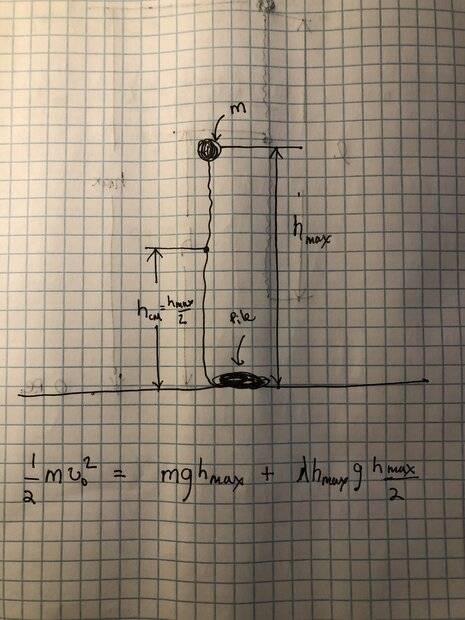

It looks like the author had mechanical energy conservation in mind. Under that assumption
$$\frac{1}{2}mv_0^2=mgh_{\text{max}}+(\lambda h_{\text{max}}) g\frac{h_{\text{max}}}{2}.$$The acceptable root of the quadratic is $$h_{\text{max}}=\frac{1}{\lambda g}\left[{\sqrt{mg(mg+\lambda v_0^2)}-mg}\right]=40 ~\text{m}$$ Under this assumption, when the length of the chain is 60 m, the maximum height is 40 m but when it is 30 m, it's more than that - I won't bother calculating how much more. I think this settles what the author had in mind and uses math at the level of an introductory physics problem.

"Under this assumption, when the length of the chain is 60 m, the maximum height is 40 m but when it is 30 m, it's more than that"
Something isn't right, because 20 m of chain is still in a pile on the ground?
The question is how high the stone rises.

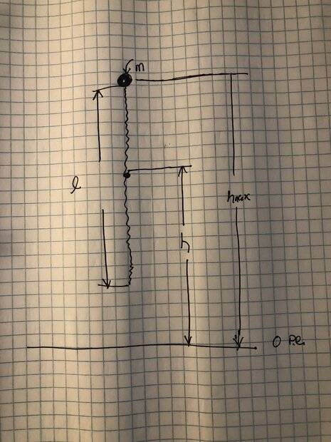

So if we let ## h ## be the CM of the chain and ## l ## be its length:
$$ \frac{1}{2} m v_o^2 = mg \left ( h + \frac{l}{2} \right) + \lambda l g \frac{h}{2} $$
Then for the stone ## h_{max}##is given by:
$$ h_{max} = h + \frac{l}{2} $$

Hand-drawn diagram on grid paper of a mass m at the top of a vertical chain of length l, with the lower part of the chain on the ground line marked O P.E., a height h marked to a point partway up, and h_max marked to the top of the mass.
This is what I was thinking, what is wrong? The fact that it assumes the chain fully lifts off the ground?

Are you trying to find how high the 30 m chain is lifted off the ground? If so, you first need to find how fast it is moving when the its end has been just lifted off.
erobz said:
The height of the stone must be higher than the height of the CM of the chain?
Yes.
Also, about ##h_{max} = h + \frac{l}{2}##.
When I wrote post #23, I thought ##h## is measured from the end of the chain.
So, If ##h## is measured from the table, then the formula works with no limitation of total chain length.

Handwritten sketch on grid paper of a mass m at the top of a vertical chain, hanging from a horizontal line at height h_max above a floor line, with a point at h_max/2 marked and a dark ellipse at the base labeled Rlkn; below is the equation 1/2 m v0^2 = mgh_max + λh_max g h_max/2.
