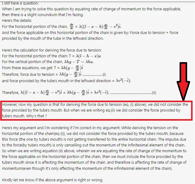

NTesla said:
This is the way I'm seeing this: When scenario 2 starts with Scenario 1, this means the vertical portion is in free fall. Now the element that is about to be attached to the top of this freely falling chain, is also falling downward with the velocity of the chain. But just before it has to attach itself to the freely falling chain, it has to suddenly lose all it's velocity. So this requires an upward impulse on this element whose magnitude is ##\lambda v^{2}##. This impulse brings the velocity of that element to zero. But you've written:"This creates... ". I don't understand what is creating this upward force.
The element that was returned to the top never left the system. The impulse that brought it to momentary rest was an external force.
The description of the scenario requires this external force. If @haruspex wishes to think of the scenario modification as having "created" the required external force, that is fine.
NTesla said:
For scenario 3 you've written:
"Now, on the outlet side, the element is already up to speed, so there is no retardation force for that. Instead, there is a tension ##T_{i} =λv^{2}## on the inlet side, just to the right of the returned element. This is transferred around the quadrant to the outlet side, so we still have ##T_{o} =λv^{2}##."
For the element on the outlet, you've mentioned that "there is no retardation force for that". And then in the next sentence you've written: "this is transferred around the quadrant, so we still have ##T_{o}##". I don't understand this at all.
In scenario 3 (returned links return to the inlet side and are brought to rest by some external force) do you agree that we have tension ##T_i## at the inlet? This tension is responsible for the internal force that brings the returned links up to horizontal velocity ##v##.
So we have tension ##T_i = \lambda v^2## at the inlet. The mass of the chain within the curve is infinitesimal. Do you agree that it follows that the tension ##T_o## at the outlet must be the same?
The argument is that any difference in tension is given by the acceleration of the entire chain multiplied by the mass of just the section that exists within the 90 degree curve (the quadrant). We can make the quadrant as small as we please. So the tension difference can be made as small as we please.
It is the tension that @haruspex speaks of as having been "transferred around the quadrant".

However, as I'm mentioned in post#93, I'm finding not just difficult to understand the explanation given in post#92 and 95, but near impossible to understand as to how the explanation given in these 2 posts is helping me understand the question that I had raised in post#84.
NTesla said:
Yes. I agree. Reason: There's no point on the chain that doesn't have tension, except the ends of the chain. So, yes, there is tension at the bend. However, I'm not sure whether the tension at the inlet would be ##\lambda v^{2}## or not. This is because, ##\lambda v^{2}## is the leftward force on the element which is on the bend. Just before this element, tension is = ##\lambda(l - h - x)##. But right after the element, I don't know what the tension will be.
Which scenario are you contemplating here? I made it quite clear that I was writing about scenario 3.
In this scenario there is nothing to the left of the element that is entering the inlet to the quadrant. The only source of tension in this scenario is the impulsive acceleration of the incremental added mass, bringing that incremental mass up to speed to match the rest of the chain.
The formula ##\lambda(l - h - x)## does not apply in scenario 3. The tension "just before this element" is undefined because there is absolutely nothing before this element.
As I've mentioned in post#93 and 96, I'm finding it not just difficult to understand the explanation given in post#92 and 95, but near impossible to understand as to how the explanation given in these 2 posts would help me understand the question that I had raised in post#84. And post#97 is in the same line of explanation.
I'm just not able to understand how all these explanations tie up altogether in answering the question that I posed in post#84.
In your previous post you've written:
This i'm failing to find useful. Whatever element is at the bend, there is chain to the left of that element and also the right of that element. And I understand that you specifically wrote this about scenario 3. But this is where I'm not able to understand any further. This different scenario situation is not at all helpful to me. I'm not able to put together how the scenario wise explanation is useful.
I request you to kindly explain the answer to the question in post#84, in some other way.
