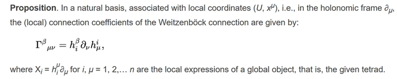

My citation in post #22 explicitly states that the equation:$$\partial_{\mu} {e^a}_{\nu} + {\omega^a}_{\mu b} {e^b}_{\nu} - \Gamma^{\sigma}_{\mu \nu} {e^a}_{\sigma} = 0$$is nothing more than the definition of ##\omega## in terms of the arbitrary chosen fields ##e,\Gamma##. (Equivalently, it can serve to define ##\Gamma## in terms of arbitrary ##e,\omega##.)
In your definition, the fields ##e,\Gamma## is chosen independently. But if we demand that the connection ##\Gamma## to be the Levi-Civita connection compatible with the metric field defined using tetrad field ##e##. Then what is the property of spin connection ##\omega##.

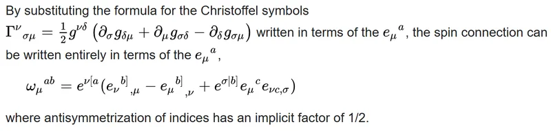

Just look at Wikiedia: https://en.wikipedia.org/wiki/Spin_connection!
So for the Levi-Civita connection ##\left\{ _{\mu\nu}^{\alpha}\right\}##, the spin-connection ##\omega## is expressed uniquely and unambiguously in terms of ##e## and its first derivatives. For more general connections ##\Gamma_{\mu\nu}^{\alpha}\,##, ##\omega## will involve the torsion ##T## and nonmetricity ##Q## tensors as well.

  • #37
Simply from a tetrad field , then we can calculate the difference between teleparallel connection and Levi-Civita connection:

Because compatible is defined with metric compatible equation, and this equation is different with the normal differential equation in ##IR^n##. But we can analyze the equation in such a way. At first we can write the metric compatible equation in the combination of two equations:
##\partial_a {e_b}^{I} = {\Gamma^c}_{ab} {e_c}^{I}## or ##e_a^J\partial_J {e_b}^{I} = {\Gamma^c}_{ab} {e_c}^{I}##.
and
##g_{ab} = \eta_{IJ} {e_a}^{I} {e_b}^{J}##.
Then I am confused by such a problem: Does the operator ##\partial_a## associate with a coordinate system. or at least is defined with a non-coordinate basis field. What is your opinion on this problem?
