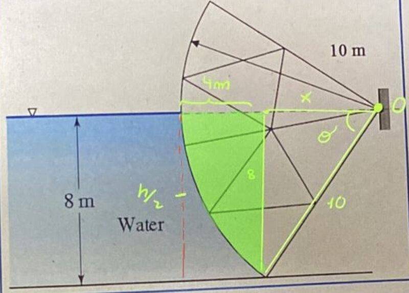

1. A "Tainter" damper has the shape of a partial cylinder as shown in the figure. The width of the damper is ##12\, \textrm{m}##. Note that the height of the water corresponds to the height of the pivot point of the gate. Calculate the horizontal force in ##\textrm{kN}##. Other data: ##\rho =1000\, \textrm{kg}/\textrm{m}##, ##I_{xx}=bh^3/12##
2. Calculate the vertical force in ##\textrm{kN}##
3. Calculate the total force in ##\textrm{kN}##
4. Calculate angle of total force in degrees
5. Calculate the momentum of the horizontal force in ##\textrm{kNm}##.
##F=pA, p=\rho h##
Figure:
Attempt at a solution:
$$b=12\, \textrm{m},\quad H=8\, \textrm{m}$$
a) $$F_H=p_{CG}A=3767040\, \textrm{N}=\boxed{3767,04\, \textrm{kN}}$$
$$A=8\cdot 12=96\, \textrm{m}^2$$
$$p_{CG}=\rho_g h_{cg}=39240\, \textrm{Pa}$$
b) $$F_V=mg=\rho_g V$$
We calculate ##\theta \rightarrow 8=10\cdot \sin \theta \rightarrow \dfrac{8}{10}=\sin \theta \rightarrow \theta =53,13\, \textrm{º}##
$$x=10\cdot \cos (\theta)=6\, \textrm{m}$$
We calculate ##A\rightarrow A=\dfrac{\pi r^2\cdot 53,13}{360}=\dfrac{6\cdot 8}{2}=22,3647\, \textrm{m}^2##
$$F_V=\rho_gV=\rho_g bA=\boxed{2632,77\, \textrm{KN}}$$
c) First of all we find ##\alpha## (angle between forces).
$$\alpha =\arctan \dfrac{F_V}{F_H}=34,95\, \textrm{º}$$
$$F=\dfrac{F_H}{\cos \alpha}=\boxed{4595,88\, \textrm{kN}}$$
d) $$\boxed{\alpha =34,95\, \textrm{º}}$$
e) First and foremost, we must locate the centre of pressure (CP).
$$y_{CP}=-\dfrac{\rho_g I_{xx}}{F_H}=-1,333\, \textrm{m}$$
$$M_o=F_H\cdot h_{cp}=F_H\cdot (4+1,333)=\boxed{20089,62\, \textrm{kN}\cdot \textrm{m}}$$

Think again about the volume displaced in part b.

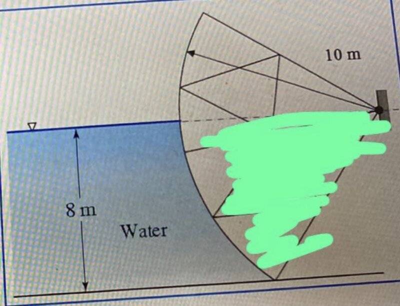

Wouldn't this be it, or would it affect everything? I can see well how I've done it, can't I?
Okay, maybe like this?

No.
It's a bit tricky. Suppose, instead of the sector of a circle given, the damper were to continue further to the right. Would that change the force? Would it change your calculation?
The area you have shaded would be correct if there were also water to the right. In that scenario, can you see a way to split the damper into two parts such that the water on the left is responsible for the buoyancy force on the left part and the water on the right responsible for that on the right part?
haruspex said:
No.
And what I have marked in the figure at the beginning of everything, neither?
What is highlighted in post #1 is correct, but I looked at your working and you do not seem to have subtracted the triangular portion. I see ##A=\pi r^2\frac{\theta}{2\pi}##.
They did. it's a typo.
Should read:
Guillem_dlc said:
We calculate ##A\rightarrow A=\dfrac{\pi r^2\cdot 53,13}{360}-\dfrac{6\cdot 8}{2}=22,3647\, \textrm{m}^2##
