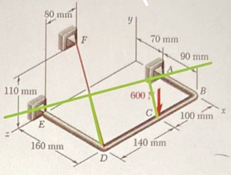

The bent bar ##ABDE## is supported by spherical plain bearings at ##A## and ##E## and by the cable ##BF##. If a load of ##600\, \textrm{N}## is applied at ##C##, as shown in the figure, determine the tension in the cable.
Solution: ##853\, \textrm{N}##

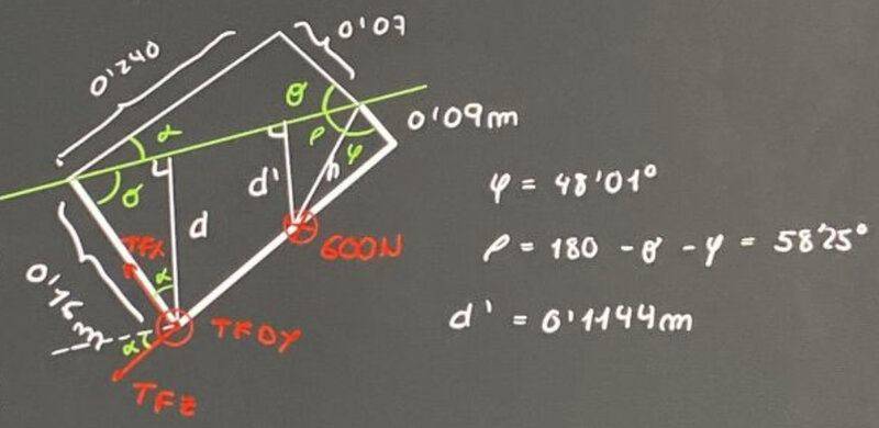

View from above:
We calculate ##D##:
$$\sigma =90-\arctan \left( \dfrac{0,07}{0,240}\right)=73,74\, \textrm{º}$$
$$d=0,16\cdot \sin (\sigma)=0,1536\, \textrm{m}$$
##TF_x## does not make moment and ##TF_z## does not make time ##\rightarrow \alpha =16,26\, \textrm{º}##
$$\sum M_{EA}=TF_x\cdot \sin \alpha \cdot d+TF_z\cdot \cos \alpha \cdot d+TF_yd -600\cdot d'$$
$$\rightarrow TFD\dfrac{0,16}{0,21}\sin \alpha d+TFD\dfrac{0,08}{0,21}\cos \alpha d+TFD\dfrac{0,11}{0,21}d=600d'\rightarrow$$
$$\rightarrow TFD=\dfrac{0,21\cdot 600d'}{d}\cdot \left( \dfrac{1}{0,16\sin \alpha +0,08\cos \alpha +0,11}\right)=405,2\, \textrm{N}$$
Could you have a look at this one?

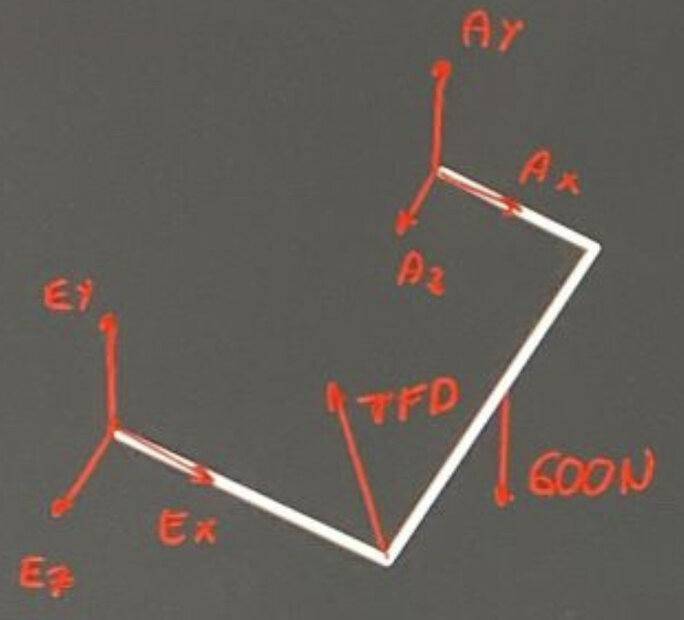

What do you get for the system if you just apply ## \sum_{x,y,z} F = 0## ##\sum_{A,E} M = 0 ## using the coordinate system already in place?
I find ##T \approx 853 \rm{N} ##. You will only actually need 3 equations in the end to answer this question by using a coordinate system offset through the point ##E## to generate the remaining two equations (you already have the third for the tension ##T## in terms of its components).
You state correctly that the x component of tension has no moment about AE, but you include such a term in the equation. Similarly the z component (but "does not make time"?).
I've ended up doing it this way now and I got it:
$$\sum M_{EA}=TF_yd-600\cdot d'=0\rightarrow TFD\dfrac{0,11}{0,21}d=600d'\rightarrow$$
$$\rightarrow \boxed{TFD=853,13\, \textrm{N}}$$
